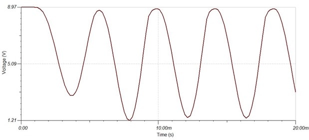

Here's the basic circuit as it's usually presented. The original had a 3k3 resistor for the collector load, but I changed that for a 2k2 (the transistor I'm using evidently has a much higher hFE than what was used originally in that circuit).
Here is the output waveform from running a transient test on the circuit
As you can see, the output sine wave isn't all that good a shape. A sine wave can have a modest amount of harmonic distortion and still look quite reasonable to the eye so, if we can see that it actually looks poor, it really is.

At start-up, the signal will build (it initially comes from noise generated by the power being applied). After a few cycles, it limits because it has grown to be almost the same, peak-to-peak, as the supply voltage. At the top end, it slows just short of the rail (giving quite a soft top) because of the very non-linear characteristic of the base as the voltage there reduces. It's also the case that each RC stage loads the previous one, with the last one working into the very non-linear load that the transistor represents, so any idea that we get a nice, neat 60 degree phase shift from each stage flies out the window. It's very messy and a simulator approach rather than an analytical one makes a lot of sense.
