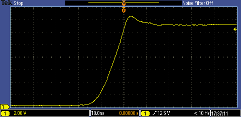

First off, I'm going to use a single 1N4148 signal diode to protect the transistor.
Here's the collector waveform at the time the transistor turns off and releases the relay coil. With a low-capacitance signal diode everything happens very fast. You can see that it's so fast that the voltage overshoots a little before the diode turns on and starts clamping it to a diode drop above the rail. The turn-on time looks to be a few nanoseconds, which is in the right sort of area for a diode like this.

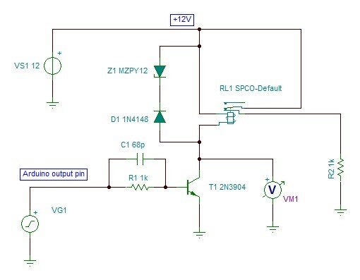

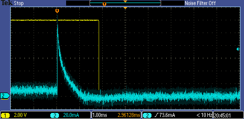

1N4148 and 12V zener across coil
This one is a bit different. Now I've got a signal diode and a 12V zener across the coil. The signal diode blocks the zener when it [the zener] is forward-biased and would otherwise short the coil. In theory this should be better than a single diode because the coil voltage will increase to 12.6V and the initial dissipation will be 12.6V x 130mA = 1.64W rather than 0.6V x 130mA = 78mW with a single diode.
Here are the waveforms
The rise time now looks a bit odd. To explain it, you'd have to think about the various device capacitances and how they get charged.
This is much better. Most of the energy from the coil is dissipated after 2mS and, though the contacts drop out at the same current level as before, by the time the contacts move we can hardly see the result of the change of inductance on the small current that the coil is left driving at that point.
