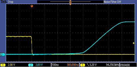

First let's look at the Arduino output by itself. I've done these with a spring-clip ground, rather than the flying-lead ground on the scope probe. You can see that the output is reasonably well behaved. The rise and fall times are about 4nS. My scope has a rise time of about 3.5nS (200MHz bandwidth), so they're about right for what I can deal with doing this experiment and it's plenty fast enough for the transistor I've selected.
This next trace shows the collector waveform when the transistor turns on. The yellow trace is the Arduino output, the blue one is the collector. (Note that the horizontal scale is changing in all of these - sorry, it's just force of habit to adjust the scope to give the best detail rather than try and maintain consistency. The white figure is the timebase - in the case of the next one it's 10nS/division - the orange figure is there to confuse you if you look quickly - it's the time that the trigger point is ahead of the display centre.) Here we can see that the transistor is slow to turn on - there's a delay of about 20nS (the 'delay time') before anything occurs and then it takes what seems to be forever to pull the collector down, the fall time being about 60ns (that one is properly known as the 'rise time' because the transistor parameter is the rise in the collector current).
Well, if you think that one's slow, have a look at the turn-off time
Yes, nothing at all happens for 400nS (known as the 'storage time') and then it takes a leisurely 300nS to get where it's going (the 'fall time' as this time the collector current is falling). What a lazy device - it's surprising it can manage to get out of bed in the morning.

Starting at the beginning, with the Arduino pin at 0V, the base of the transistor will also be at 0V. When the Arduino pin goes high, the first thing that has to happen is that the internal capacitances within the transistor (Cbe and Cbc) have to charge. They do that through the 10k base resistor and the initial delay time is the time it takes to get the base up to around 0.6V where the transistor will start to turn on. At that point, charged carriers start to accumulate on the base and the collector current starts to increase in proportion. Eventually, the collector voltage falls below the base voltage, and as it approaches zero the base-collector diode becomes forward biassed and the base injects carriers in to the collector region - this is called saturation.
When it comes to turning the transistor off, all those charges in the collector region have to be removed first (through a reverse current flowing out of the base) before the base charges can be removed and the collector current reduced.

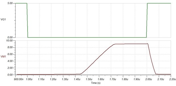

    I got to wondering how good a spice simulation of a transistor would be - specifically, whether it might model the saturation.
    Here is my circuit (without speed-up capacitor) simulated with TI-TINA, using the 2N3904 that comes with that package
    Compared with my trace, it's very similar. The saturation time is slightly longer, but presumably that varies between manufacturers, anyway. Similarly, the delay time and the rise and fall times look to be reasonably accurate (slightly less than I'm seeing with a real device), so the model includes the internal capacitances.
