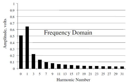

Looking at the same signal represented in the frequency domain (Figure 4), we note that the harmonics drop off in a well-defined pattern: Amplitude (A) = 2/πn, where n is the number of the harmonic.
Figure 4: An ideal square wave shown in the frequency domain

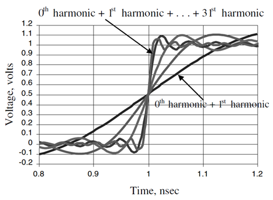

How do these two domains connect? We can take this frequency spectrum, each of these frequency components being sine waves, and we can recreate, or synthesize, our ideal square wave in the time domain by summing all of these frequency components. Were we to add only, say, the first three harmonics (up to and including the fifth) and ignored the rest, we would be defining the highest frequency component in our spectrum. But we could go on to add the 7th, 9th, 11th, and so on, and in doing so, we would be impacting the rise time of our synthesized square wave.
Figure 5 shows us that impact; the straight plot is the fundamental frequency and 1st harmonic with the rest being higher harmonics. As we add more harmonics, or higher frequency components, the highest of those frequency components can be termed the signal's bandwidth, or, more precisely in this case, the engineered bandwidth. Adding harmonics increases the bandwidth until we reach about the 17th harmonic, above which there's little of significance left in terms of amplitude.
Figure 5: Rebuilding an ideal square wave from its frequency components

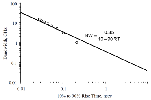

If we plot bandwidth vs. 10-90% rise time for these frequency components, we'll see that they fit into another well-defined pattern. The bandwidth is the inverse of the rise time, and it turns out that the bandwidth = 0.35/10-90% rise time. The graph in Figure 6 clearly shows the relationship between bandwidth and rise time, and this is the basis of that rule of thumb connecting the rise time of a signal and its highest frequency component. Thus, if you decrease the rise time, you increase the bandwidth, and vice versa.
Figure 6: A plot shows the relationship between bandwidth and rise time
