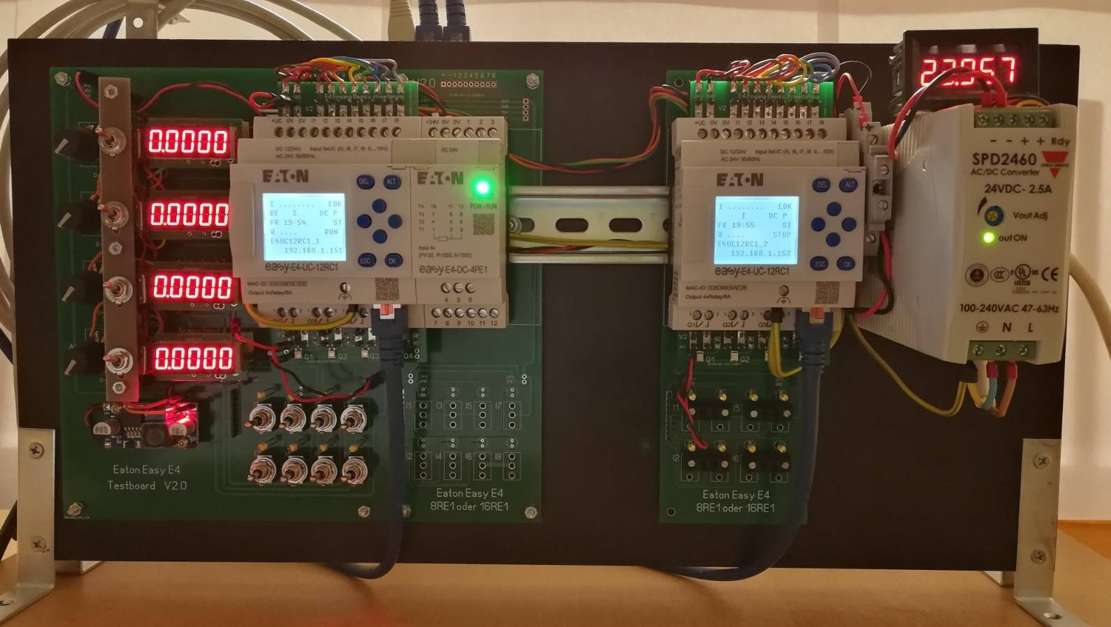

The Testboard:
left: 4 analog inputs with V-meters and DC/DC 10V, controlled with potentiometers, switchable analog/digital;
middle: the E4 PLC number 1 with the E4-DC-4PE1; below are the 8 toggle switches for the digital inputs
right: ES PLC number 2 wired for external input connections. The 24V AC/DC PSU.

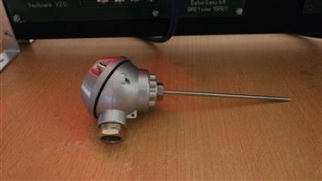

2nd image: with this PT100 sensor I will show in the next part of the RoadTest the function of the expansion module.
Behind of this board a LAN switch makes the connection to the LAN and my computers.
