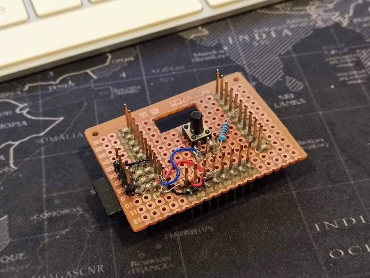

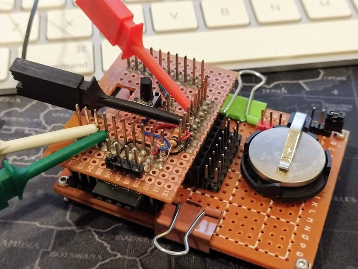

I decided to make a small shield with some necessary components on it, so I can just snap it on top of the prototype dev board I had and I don't have to make anything permanent.
  • On the left side is a female header that connects the USB VBUS, D-, D+ and GND to the nRF52840 directly.
  • There's also the red wire to connect VBUS to VDDH.
  • A 10k resistor pulls up the reset pin through VDD
  • A momentary switch is connected to the reset pin, which then is shorted to ground via a 1k resistor when pushed
I then downloaded the pre-built hex binary from https://github.com/adafruit/Adafruit_nRF52_Bootloader/releases/tag/0.3.2 (I used the pca10056_bootloader-0.3.2_s140_6.1.1.hex) and flashed it via SWD

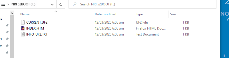

Attaching a USB cable will then present the UF2 bootloader as a disk drive with the label NRF52BOOT

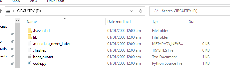

Dragging the uf2 file onto the bootloader reboots the chip and then presents it as a disk drive with the label CIRCUITPY

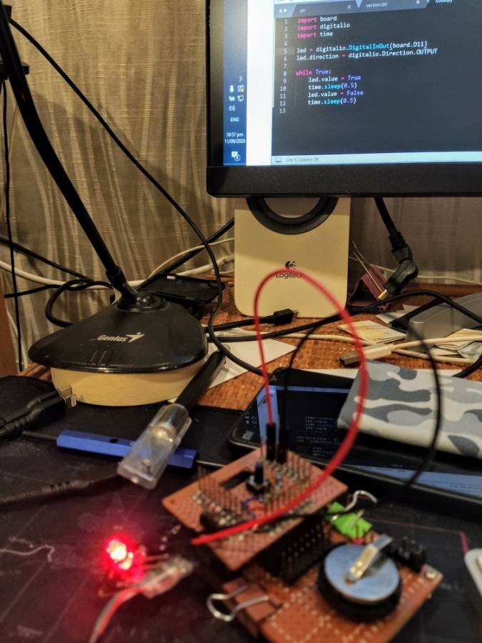

Editing code.py and then saving it with a small blink sketch works as expected. I had to refer to https://github.com/adafruit/circuitpython/blob/main/ports/nrf/boards/sparkfun_nrf52840_mini/pins.c  for the pin definitions as SparkFun didn't use the matching pin numbers for the silkscreen.
