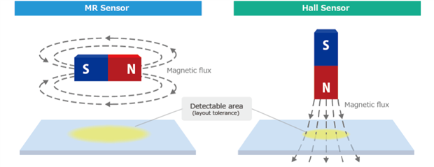

The Difference Between Hall Sensors and MR Sensors
A Hall sensor detects the strength of a magnetic field perpendicular to it, whereas an MR sensor detects the angle of a parallel magnetic field.
For that reason, MR sensors generally have a wider detectable area that absorbs layout error.
Alps Alpine MR sensors also have an excellent signal-to-noise ratio as output is at least 10 times higher than a Hall sensor.
