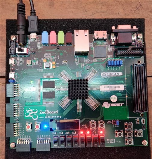

This is my first technical blog which will introduce the readers to the ZedBoard setup for the programmable logic application. It will help first-time users with the setup and develop their first FPGA project.

How to set up the ZedBoard for programmable logic applications?
Step 1:Plug the 12V power supply into the barrel jack (J20). Do not turn on the board
Step 2: Shunt the jumpers JP7-JP11 to the ground.
Step 3: Connect the USB cable(JTAG) to micro USB-B(J17).
Step 4: Slide the power switch (SW8) to the ON position. You will see the green LED (LD13) illuminates.
