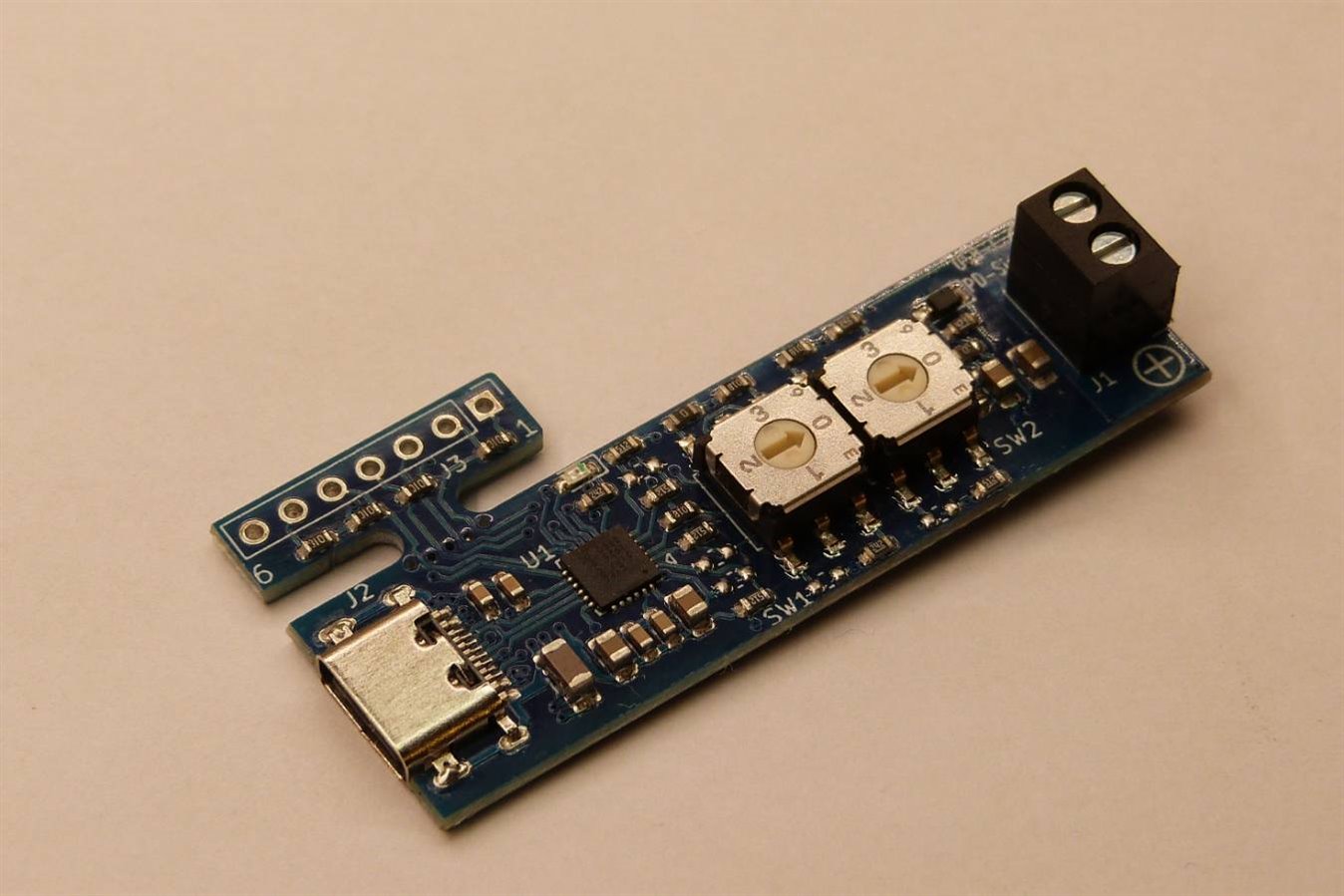

A USB-C PD Sink up to 20V 5A based on the Cypress CYPD3177 USB PD Controller
Edit: NEW Rev 4 now available. Important improvement with a 2nd switch to select the current! New FETs have a Rds_on of only 9.5 mOhm, which cuts the dissipation almost in half and keeps the board cooler, even with 5 A current draw.
USB-C PD offers the option to negotiate power delivery from a compatible power supply. This board plays the role of a sink device, enabling any device to be powered from a USB power supply. Any type of power connector can be attached through a 2-pin screw terminal or directly soldered into the PCB for a lower profile.
The voltage can be set to 5V, 9V, 12V, or 20V and  current can be set to 1A, 2A, 3A, or 5A.
BCR stands for Barrel Connector Replacement, the term is invented by Cypress, the manufacturer of the controller chip in use here.
Details
This board has the goal to replace random power adapters with a standardized way to use a USB-C power delivery (USB PD) adapter instead. For regular operation, no programming or software configuration is involved with this design. All options are set through the switches or resistor values. If needed an I2C interface to a microcontroller is available, to access status and control registers. This part of the board is separated through a break-off tab (mouse bites) and can be snapped off. I made the conscious design decision to not add a USB-A connector option at the output end. I did not want to build a device, that is capable of putting more than 5V on the VBUS pin of a regular USB cable and potentially destroy the device that is plugged in. A heatshrink tube can protect the board in a permanent installation.

    shabaz over 6 years ago
    No schematic? Otherwise it's just an ad for a product it seems.
    Jan Cumps over 6 years ago in reply to shabaz
    There’s more info on https://hackaday.io/project/168762-usb-c-power-delivery-sink-bcr
    https://cdn.hackaday.io/files/1687627220313408/SC%20USBC-Sink_ver1.pdf

    Jan Cumps over 6 years ago in reply to wolfgangfriedrich
    wolfgangfriedrich  wrote:
    All is updated with rev 2 files now.
    New FETs, additional caps on the CC lines and an extra pull-up on the flip.
    What made you do these changes? Border cases where these components improved the design?
  • wolfgangfriedrich
    wolfgangfriedrich over 6 years ago in reply to Jan Cumps
    The caps on CC are a recommendation from Cypress in their reference design, the extra pull-up I found during my integration testing.
    And there are also an extra pull-up and zener diode between gate and source at the new FETs to protect them and not exceed the max gate-source voltage.
    The new FETs are for better temperature management. At 5A there is power dissipation of almost 0.5W per FET, which I wanted to spread between 2 packages. They still get very hot at 5As that some temperature management is recommended. 4A is the limit for still air operation. I found even better FETs with lower Rds-on but in an ugly package, a Rev 3 is probably coming in the near future.
