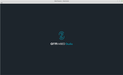

Then in June 2020, I spotted an announcement from MBED that version 1.0 of Mbed Studio had just been released and that this was available for download on Linux OS.
I was curious to see what this IDE could do, so I went ahead and installed this IDE on my computer from the MBED Studio web page. This installation process also installs the MBED CLI and a bunch of other testing tools (e.g. MBED Greentea), which may come in handy at a later stage.
Let’s get started with MBED Studio
MBED Studio is based on the Eclipse Theia IDE, which according to the Theia website, embraces many of the design decisions and even directly supports VS Code extensions. Hence, the IDE looks remarkably similar to Microsoft’s Visual Studio Code, which is not surprising considering that also both are use the Monaco Editor.
For those familiar with Visual Studio Code, you'll get a similar user experience when launching MBED Studio.

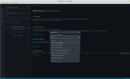

When you launch MBED Studio you are presented with a Getting Started page. This page provides options to open a workspace and to create a program. It also allows you to report an issue, although I found that this requires an SMTP server etc.
My natural instinct was to gravitate towards the message “Start your next IoT project” on the left hand pane and click on the large “+ New program” button beneath. This opens up a “New program” dialogue box which allows you to select an example program and give your program a name.
As you can see, you are presented with a small selection of example programs for either MBED OS 6 or for MBED OS 5.
My immediate thought was that this must be legacy related. It is also worth noting that the IDE does not prevent updates, because if you go and select an MBED OS 5 example it will use mbed-os 5.15.4 but then the IDE will still notify you to update the MBED OS to the latest version, which at the time of writing this is OS version 6.2.0. So beware, you’ll soon learn the reason why you are given the two options and also to not automatically update all MBED 5.x examples to MBED 6.x. One key reason is that external libraries created using MBED OS 5.x will seldom work on MBED OS 6.x. More on this later.
Another first impression I had was that I felt that the 7 “official” examples listed for MBED OS-6 / OS-5 was rather limiting. Not to worry, as I soon discovered that if you head over to the Code page on MBED website you can use any of the official or user-contributed examples listed there too (although you need to be mindful that not all MBED compatible hardware works seamlessly on MBED Studio - remember, it’s only version 1.0 and that most libraries found listed here are for MBED OS 5 or even MBED OS 2).

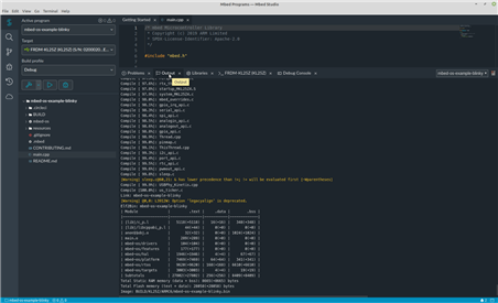

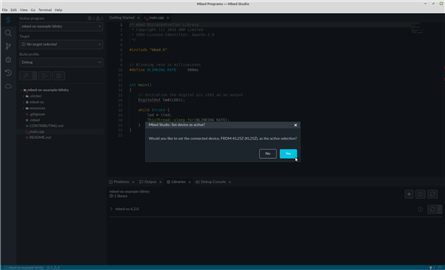

Let’s now start with the proverbial “Hello World” example (mbed-os-example-blinky) using the latest MBED OS 6.2.0.
If you open up main.cpp, you may be like me and be rather surprised to see code syntax errors. The reason you get this is that no “Target” has been selected. This is very similar behaviour to the online compiler, which links your example to hardware.
I discovered by accident a quick way to choose your target. Simply plug the board in and if it has a compatible debug/flash/bootloader interface it will automatically be detected.
As I was just learning, I started with an MBED board I was familiar with, namely a FRDM-KL25ZFRDM-KL25Z board. My FRDM-KL25ZFRDM-KL25Z board is a good few years old but it still works. Here you plug the USB cable into the OpenSDA port and after a good couple of seconds a message pops up on the screen as you if you want to set the device detected as active. Clicking “Yes” selects the target for you. Now you will find all those code syntax errors have been resolved.

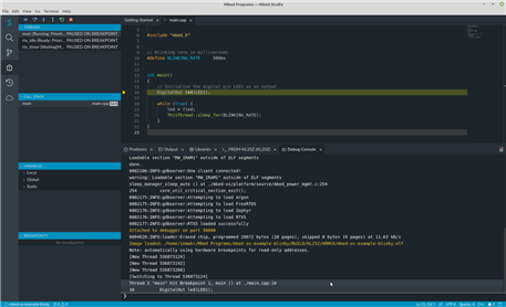

We are now ready to compile or build our program. To do that we select the hammer icon on the left hand side of your screen (below the Build Profile selection option). The first compile does take awhile (a couple of minutes depending on the speed of your computer) but you are provided with a running update on the output console.
We now have two options. Either “run” or “debug” your program. If we select the “debug” option we are now presented with a helpful debug screen:
But as this is such a straightforward program, the run option is all you need to see the blinking LED. Here's a video capturing the whole start to finish process:

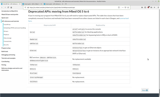

Besides using a developing IDE, the biggest challenge you’ll have to date is getting some of the many user-contributed examples to work with MBED OS 6.x as currently most are written using MBED OS 5.x or even MBED OS 2. The good news is that MBED 6.x has a bare metal profile to cater for OS 2 and the standard thread based profile for new and OS5 type examples.
The website does document the deprecated API's, which will help you when moving from MBED OS 5.x to OS 6.x (in most cases you usually just get a warning if still used).
I also noticed that MBED OS 6.x changes go beyond just deprecated functions. From what I can make out there are plenty of breaking changes to the functions themselves. Here is one example for the “InterruptIn” class. In this case if an OS 5.x example uses the “InterruptIn” class then this will cause an error if trying to port across to OS 6.x. Here is Version 5.14 and here is Version 6.2.
Despite these changes, from what I’ve noticed (although I am certainly no expert) things look much neater with MBED OS 6 than MBED OS5 and confirms to me that MBED really is maturing into something really good.

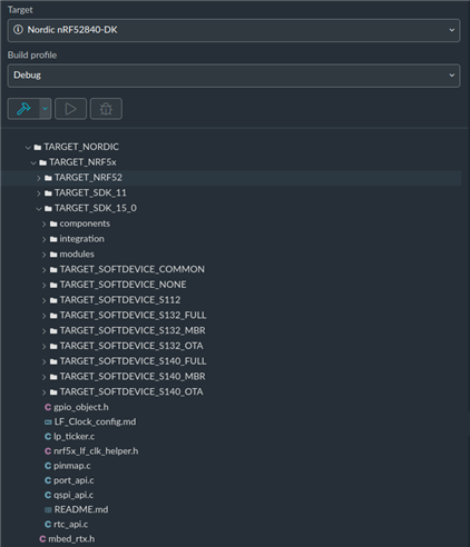

The two expressions worth noting are “target.features_add”, which adds in the BLE feature, and “target.extra_labels_add” which links in the Cordio BLE stack if it’s required for the module to work. For the Xenon board all we need is the "target.features_add": ["BLE"] property.
If you want to delve a little deeper into what makes up the “NRF52840_DK” target on MBED, you'll need to look within the MBED OS directory in your example application on MBED Studio.
Here we can see that the “TARGET_NORDIC” includes the Nordic Semiconductor’s SDK 15 and the relevant “SOFT_DEVICE” bootloader packages.
There is also a README.md file within the TARGET_NORDIC/TARGET_NRF5x folder that provides further explanation on further refinements you can, if needed.
For me, I stuck with the defaults and they seem to work fine.
