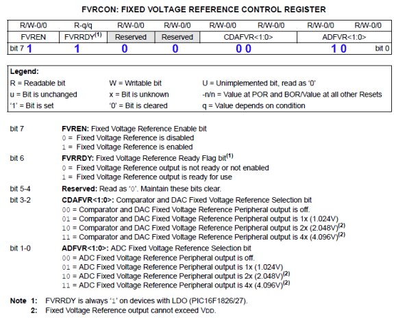

The FVR output voltage is actually 1.024 V, but with the  help of programmable gain amplifiers, it is amplified by 1x (1.024  V), 2x (2.048 V), or 4x (4.096 V), to produce the three possible voltage  levels. The FVRCON register (shown below) is used to configure the settings for the fixed voltage reference. The individual bit values of FVRCON  register to generate 2.048 V as the positive voltage reference for A/D conversion are shown below in blue color font.

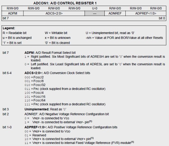

Once the FVRCON register is configured, the choice of reference voltage for A/D conversion is made through ADCON1 control register (shown below). By setting  ADPREF<1:0> bits to ’1′, the positive reference voltage for A/D  conversion is derived from the internal FVR module. Clearing the ADNREF  bit connects the A/D negative reference voltage pin to the ground (VSS).
Now the reference voltage is set to the FVR output, the rest of the A/D conversion process is similar to any other PIC microcontroller.

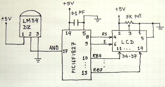

In the following link I have described the full software implementation of FVR module in A/D conversion for reading the analog output from an LM34 temperature sensor. I hope you will find it useful.
http://embedded-lab.com/blog/?p=3045
