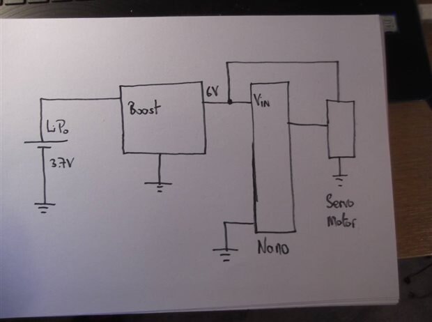

I was originally going to 'remove' the crank in some way and directly drive the musical box cylinder but after some examination and considering of how to actually remove the handle (it looked difficult) I decided it would be better to leave the crank handle in place and just use a micro servo motor with an arm to turn it instead.  For the controller I could have used almost anything as it only needs one digital output but I had some Arduino Nanos without headers so I used one of those. I wanted it to be battery powered but AA and AAA batteries take up considerable room and I wanted to keep the whole product as small as possible, so I used a LiPo battery. I had some 1000 mA hour batteries so I used one of those. As the Nano and the servo motor needed 5V or 6V really, I decided to use a small booster board to increase the 3.7V from the battery to 6.0V. I would have preferred a booster charger but the only ones I could find were far too expensive so when the battery goes flat I'll just unplug it and use the LiPo battery charger PCB I have. There are no other LEDs or sensors as there wasn't enough time to write the programme so the circuit is very simple and is illustrated below. Sorry the image is a bit dark, I'm not entirely sure why as there seemed plenty of light when I took the photograph.

The hole in the box at the back is because the crank handle just protrudes slightly so it was either a hole or a slightly bigger box. I went for the hole and then covered it over with a piece of white paper - it is at the back to so doesn't show. Not a great solution but the remaining time was being measured in minutes rather than hours. I would like to be able to claim that the compartment next to the servo motor was specially designed to hold the battery, Nano and booster PCB, but it wasn't. It is pure serendipity that I could manage to squeeze everything in - just. Sadly, because of a slight mistake with the positioning of the hole for the on/off switch (which I also forgot to add to the  circuit diagram) there was no room inside the box for it's connections so I had to hot glue it to the front. Not a good finish but it works. I must get some better on/off switches.
The programme is also very simple, just being a for loop to output the required number of pulses needed to keep turning the musical box crank handle at the required speed and required duration, as listed below. Both the speed and duration were found by trial and error. It plays the tune and then stops. It has to be turned off then on again to make it play again.
