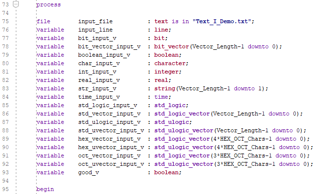

Then declare the file(s) of interest in the process, but before “begin”:
                file      input_file  : text is in "Text_IO_Demo.txt";
Warning: the line above is in VHDL87 style. This may cause errors or warnings. If so then use the following syntax:
                file      input_file  : text open read_mode is "Text_IO_Demo.txt";
Note that 'input_file' is 'file' object and its type is 'text'.
"Is in" specifies the directory of the text file. If it is included in the project, then you can use only the filename, otherwise you have to include the file directory as well such as:
                file      input_file  : text is in "C:\Text_IO_Demo.txt";
There is also an alternative way of accessing the file, which is written like:
                file input_file     : text open read_mode is “Text_IO_Demo.txt”;
and respectively
                file input_file     : text open read_mode is “C:\Text_IO_Demo.txt”;
Also other than "text" type, there is "intf", which stands for "integer file", but I wasn't able to find enough info about it, so I decided to skip it.
As for the file extension - I have seen all kind of examples like ".csv", ".vec" and ".out", however I have worked only with ".txt", therefore I prefer to stick to it for now.
Next, there should be a variable of type ‘line’ that is used to store each individual line - the text file is processed line by line. The individual line objects are added/extracted separately. This will be demonstrated later.
variable input_line  : line;
Then the user must declare the carriers of each individual line element, and because I would like to evaluate every single type of the above mentioned,
I have 16 different variables in my process. Variables are needed only for the reading operation.
variable bit_input_v                   : bit;
variable bit_vector_input_v    : bit_vector(Vector_Length-1 downto 0);
variable boolean_input_v        : boolean;
variable char_input_v                : character;
variable int_input_v                   : integer;
variable real_input_v                 : real;
variable str_input_v                   : string;
variable time_input_v               : time;
variable std_logic_input_v       : std_logic;
variable std_vector_input_v  : std_logic_vector(Vector_Length-1 downto 0);
variable std_ulogic_input_v    : std_ulogic;
variable std_uvector_input_v : std_ulogic_vector(Vector_Length-1 downto 0);
variable hex_vector_input_v  : std_logic_vector(Vector_Length-1 downto 0);
variable hex_uvector_input_v : std_ulogic_vector(Vector_Length-1 downto 0);
variable oct_vector_input_v  : std_logic_vector(Vector_Length-1 downto 0);
variable oct_uvector_input_v                : std_ulogic_vector(Vector_Length-1 downto 0);

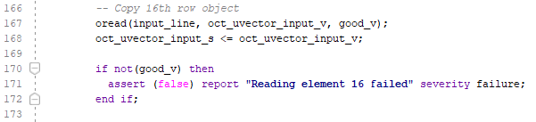

Notice that whenever the value in the text file does not match the predefined type in the test bench, the signal is ether filled with U's or not updated at all.
To detect this kind of situations, you can use the third argument of read(), hread() and oread() operations, which is a feedback (of type boolean) that indicates the 'integrity' of the object.
Hence if the element in the text file contains only characters that are valid for the respective variable, then the feedback is true,
else if the object contains characters other then the expected ones the feedback is false.
Example: if you want two read a hex value composed of 2 characters, let's say x"0f", but in the file there is x"0k" or x"0", then the feedback returns false.
The idea of the feedback is to detect bad objects and eventually take certain action in order to apply a legal value to your signal.
Note that you can only read the same amount of elements that are in the current row or less, but not more. This means that the text file rows can have variable amount of elements,
but the code should never try to extract more elements than there really are in the current row, else the variable will not be updated or it will be filled with U's.

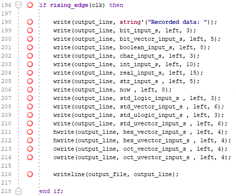

WRITING
When writing, the order of operations is the opposite:
     1.  Write data to the line.
     2. Write the line to the text file

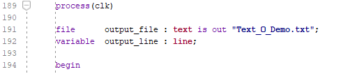

But first the output file and the line has to be declared:
                file      outfile : text is out "Report.txt";
                  variable  outline : line;
Unlike the reading operations the arguments when writing don't have to be variables, therefore in this example I fill the output file with the data contained in the signals from the reading process.
The only difference is that the data is "resampled" every 10ns, instead of being exact copy of original.
To write data the following function is used:
                write(output_line, bit_input_s, left, 4);
Where the first argument is the output line, the second is the object of interest (the signal or variable),
the third one is the position of the object within the allocated amount of characters defined for the writing operation (therefore it can have values only of “left” and “right”) and the last one is the amount of characters reserved for this object.
For example if the amount of characters you want to write is '1', but you allocate '4', then in the text file you will see one character and three white spaces.
The by using "left" or "right", you can adjust the staring position of the input string relative to the reserved space. Hence, setting "left" will result in "1 " and setting "right" will result in "   1".
You can add more objects to the line with additional write() statements or you can write the current content of the line to the text file by having the “writeline” command.
That is it.
One suggestion is when you write multiple objects in a line always put some space between them. This can be done by allocating a bit more space than the object really needs.
On the other hand if you define too few character, the object will not be truncated and if you write another object, then they will be concatenated.

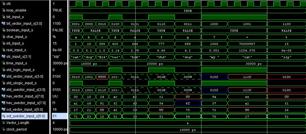

This is how I perform the Text IO operations in my designs. Sometimes if the read operation is not valid, then you should check the spacing between the line objects.
I'm quite sure there are some features I haven't covered in this post therefore if you thin something more can be added then let me know in the comments.
You can get the source code as well as the Vivado project from Github repository. Try to modify the values and see what happens.

Output file content
Recorded data: 1  0001 TRUE    a  1         0.000000e+00   cat  5 ns    1  0010  1  0010  00  A1  17  71
Recorded data: 0  0000 FALSE   b  10        1.000000e-01   dog  15 ns   0  1001  0  1001  10  C8  21  53
Recorded data: 0  0010 FALSE   c  500       1.000000e+00   E14  25 ns   0  UUUU  0  0110  2D  91  XX  10
Recorded data: 1  0100 TRUE    d  420       3.140000e+00   tes  35 ns   1  101-  1  101-  AC  F2  42  51
Recorded data: 0  0101 FALSE   e  666       2.780000e+00   bik  45 ns   0  011L  0  011L  B2  D3  53  30
Recorded data: 0  0101 FALSE   e  666       2.780000e+00   bik  55 ns   0  011L  0  011L  B2  D3  53  30
Recorded data: 1  0110 TRUE    f  777       6.660000e+00   vhd  65 ns   1  001H  1  001H  C1  54  XX  51
Recorded data: 1  0110 TRUE    f  777       6.660000e+00   vhd  75 ns   1  001H  1  001H  C1  54  XX  51
Recorded data: 0  0011 FALSE   g  888       4.200000e+00   dog  85 ns   0  000W  0  000W  XX  6Z  75  54
Recorded data: 0  0011 FALSE   g  888       4.200000e+00   dog  95 ns   0  000W  0  000W  XX  6Z  75  54
Recorded data: 1  1000 TRUE    7  1000      1.000000e-03   my   105 ns  1  010Z  1  010Z  9A  37  71  70
Recorded data: 1  1000 TRUE    7  1000      1.000000e-03   my   115 ns  1  010Z  1  010Z  9A  37  71  70
Recorded data: 1  1001 TRUE    =  76000987  1.204578e+03   cat  125 ns  1  111U  1  111U  EE  A1  XX  17
Recorded data: 1  1001 TRUE    =  76000987  1.204578e+03   cat  135 ns  1  111U  1  111U  EE  A1  XX  17
Recorded data: 1  1001 TRUE    =  76000987  1.204578e+03   cat  145 ns  1  111U  1  111U  EE  A1  XX  17
Recorded data: 0  1100 FALSE   %  15        8.000000e-06   slp  155 ns  0  010X  0  010X  XX  F1  16  51
Recorded data: 0  1100 FALSE   %  15        8.000000e-06   slp  165 ns  0  010X  0  010X  XX  F1  16  51
Recorded data: 0  1100 FALSE   %  15        8.000000e-06   slp  175 ns  0  010X  0  010X  XX  F1  16  51
Waveform diagram
