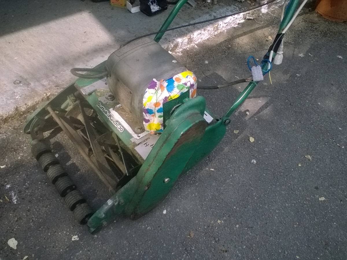

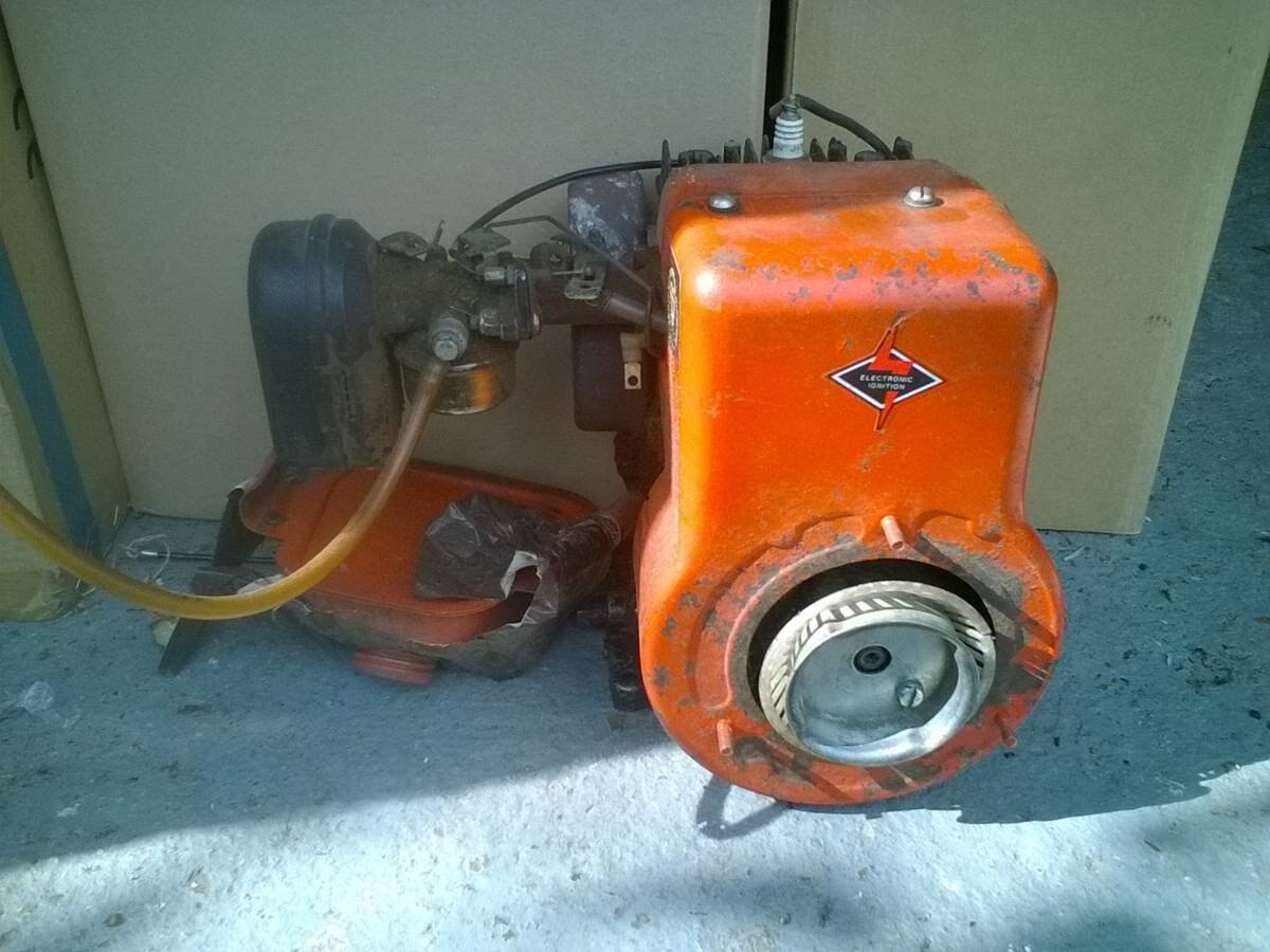

  • No progress as a high-priority job came up: mowing the lawn!But that took some hardware work, as the petrol engine had a completely broken starter mechanism and defective petrol tank valve. By valve, I do not mean a beam-tetrode! Anyway, you can see the before and after pictures here...

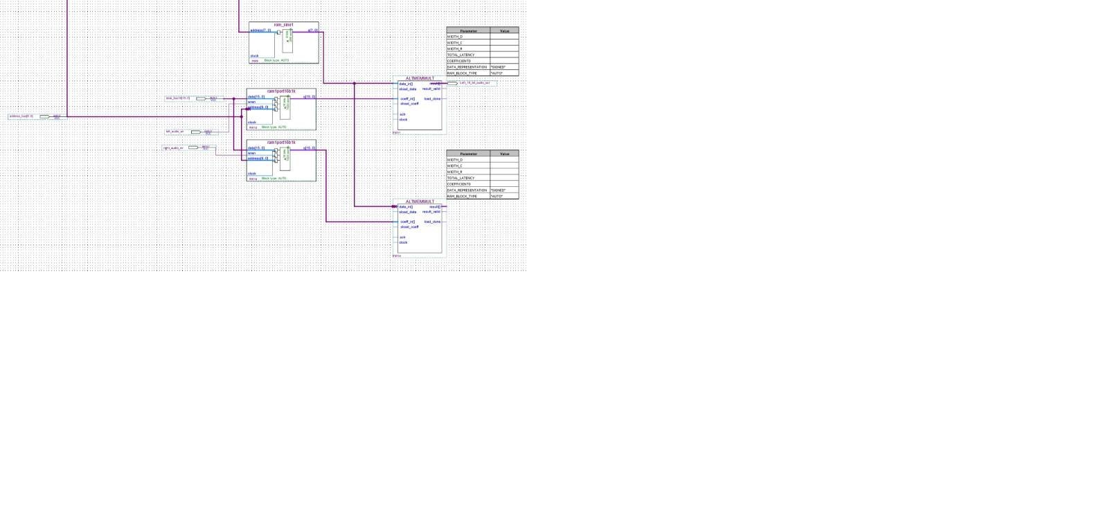

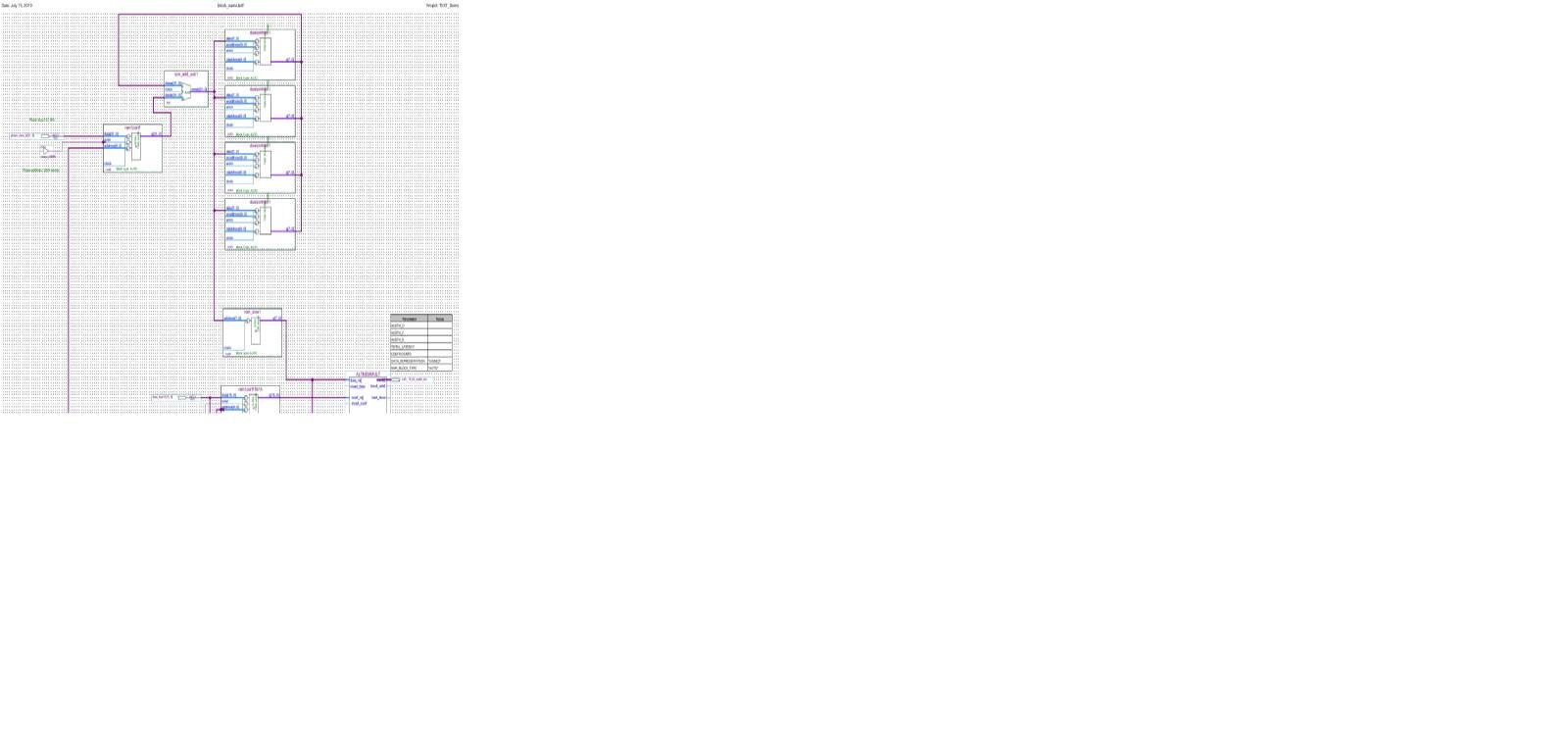

    • Project day 16086.Here is a block diagram of the system. It is a 1024-channel stereo sine wave generator. However I have not wired up the inputs, outputs or clocks and one or two other bits.Also I have not yet worked out how to add two 10-bit data address generator block for the multiplexed NCO. The subtlety is that the second DAG needs to count 7 behind the other one, as 7 is apparently the latency of the MAC.If anyone can assist I would appreciate it!It assumes the NCO can run in one cycle. The NCO is multiplexed over 1024 channels. A sine look-up table converts the top part of each NCO output to a sine wave. The sine wave is multiplied by the left gain for that channel and accumulated.Same goes for the right stereo channel.After 1024 accumulates the left and right accumulators need to be cleared, which again is something left off.Everything is pipelined and each block should run in one clock cycle.It should be easy to copy this block N times until we either run out of silicon or get to 8,000 channels, which should be enough! That is if it fits of course...
    • I was unable to attach the block diagram- illegal file type or some such message, so I took the PDF file and stuck it into Paint then printed as JPEG. Not ideal...Bottom bit is first...imageimage
