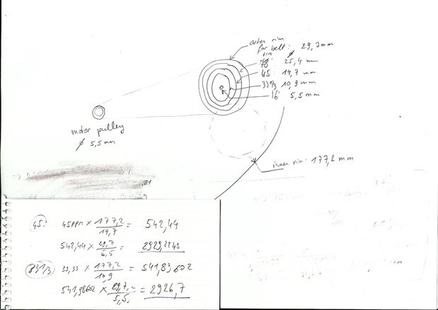

In this post I'm measuring up the different gears, pulleys and wheels, and I calculate the speed of the original motor.
To measure the original motor's speed, I need to know the size of the gears that play a role in power transfer.
Because the desired platter speed is known (16 - 33 1/3, 45 and 78 RPM), I can  trace back the original motor's speed when I know the reduction ratios.
Three measures play a role here:
  • The motor pulley,
  • The step pulley
  • The outer rim of the table platter.
The motor speed is transferred to the step pulley via a belt. So the first factor is the size of both pulleys.
The speed of that step pulley is then transferred to the platter. The idler takes care that the spinning of the step pulley is transmitted.
That idler can move up and down to select a particular position of the step pulley.
That is how the right speed is selected: by putting the idler on the part with the correct diameter for the given speed.
So two factors play a role in deducting the speed:
  • the fixed ratio between motor pulley and step pulley. It doesn't change when the speed selector is operated, hence a fixed ratio.
  • the variable ratio between the steps on the step pulley and the outer rim of the platter (those are the two parts that are connected via the idler wheel)
The size of the belt and the diameter of the idler don't come into play. They just transfer the power between two rotating parts.
That gives me the following measurements and results:
The formula to derive the motor speed from the platter speed is:
[platter speed] * ( [platter diameter] / [stepper speed diameter] ) * ( [stepper outer rim diameter] / [motor pulley diameter] )
examples:
45 RPM: 45 * (177.2 / 14.7) * (29.7 / 5.5) = 2940.3 RPM
33 RPM: 33.3333 * (177.2 / 10.9) * (29.7 / 5.5) = 2934.0 RPM

165.529.7
5.4
5.5177.232.22782.1
16 2/35.529.75.45.5177.232.22898
33 1/35.529.75.410.9177.216.32934.0
455.529.75.414.7177.212.12940.3
785.529.75.425.4177.27.02948.4
All 4 calculations should result in the same motor speed number. My measures are not precise, and that shows in the results.
The 3 highest speeds are close. 16rpm is off compared to them. I must have made a mistake when measuring that part on the step pulley - also its bigger ratio makes that a mismeasure effects the calculation most.
The above table and explanation is edited after a comment from RPLaJeunesse. He explained that 16 RPM is not exactly 16 RPM, but the half of 33 1/3 RPM. The 16 RPM figure is now in line with the 3 other speeds.

    Jan Cumps over 11 years ago in reply to RPLaJeunesse
    You are correct, RPLaJeunesse. When I make a more precise calculation using (100 / 3 / 2) for 16 RPM, I get 2898.
    That's well in line with the expected motor speed.
    Thanks!
  • RPLaJeunesse
    RPLaJeunesse over 11 years ago
    Jan, you might want to redo your spreadsheet using 16-2/3 RPM as the target speed, not 16 exact. IIRC that speed was intended to be exactly half the 33-1/3 speed, which made cutting the low speed master easier.  A 16-2/3 master could be done on a record lathe at 33-1/3 by running the master tape at twice the original speed. At 16-2/3 the motor speed calculates closer to 2900 RPM. The 2940-ish speed you calculate seems about right for a 50Hz motor, as the no-slip speed for a 2-pole motor would be 3000 RPM. But any non-synchronous motor has some small amount of slip, and thus runs a bit slower. In the 60Hz world motors are 1800 and 3600 RPM before slip, with 1750 RPM being the number I remember for a 4-pole motor with slip.
