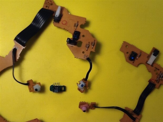

My sensor bin is empty at the moment. I used the last one in the coin detector of a drink dispenser.
I checked my pile of discarded gear, and picked up a defect video player. These have a significant amount of mechanics in them. They're good for sensor harvesting.
And I wasn't disappointed: IR transmitters and receivers (some mounted in a plastic holder), an opto-coupler with gap (could be handy if I decide to measure the belt speed), and a device I haven't found any info on.
So that means that I can once again choose the simplest option. And that's one of those IR LED pairs mounted in plasic.

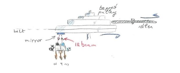

The combination of these two simplest options gives this possible solution:

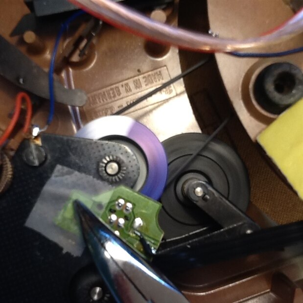

make a small part of the backside of the pulley reflective with a tiny mirror, and mount the sensor pair close to it.
If I reuse the original PCB, I can use that as mounting point.
I tested this, and it works really well in practice.

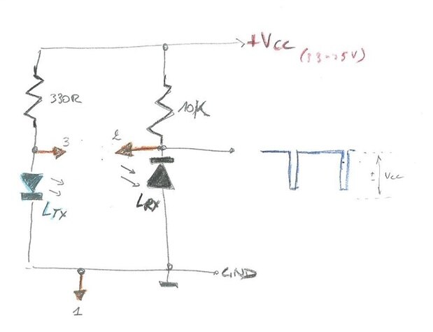

I get a nice pulse without bounce using this simple schematic:
The resistors have rough values here. They are the 330 Ohm and 10K ones that come with the typical Arduino kits.
I tested with 5V. I'll recalculate them when I adapt the circuit to 3.3V.

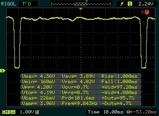

Here's what the output looks like on an oscilloscope. The measurement was done with the circuit taped in place and the motor spinning:
This signal is clean enough. I am going to use the eCAP (enhanced capture) module of the Hercules Launchpad to measure the speed and use it as the feedback data.

    I managed to record the speed of the pulley with a microcontroller today.
    There's a slight difference between the values of the scope and controller, but that is comfortably below the threshold for my application.
    In essence, all electronic work is now finished. The rest I'll need to do in the firmware.
    The scope signal is the inverse of the one in the blog post because I put a single transistor buffer between IR detector and microcontroller input.
