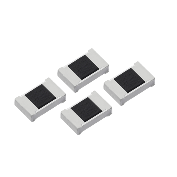

Panasonic introduces the NEW ERJ-P6W Series Anti-Surge Film Chip Resistors! By utilizing a double-sided resistive element, electric current flows through the top and bottom of the element improving pulse characteristics and better protecting the circuit.
Boasting a high power rating of 0.5W and 1.5 times higher pulse withstanding capability than previous models, the ERJ-P6W Series meets IEC 60115-8, JIS C 5201-8, and EIAJ RC-2134B reference standards. This resistor series is also AEC-Q200 qualified for high reliability in automotive applications and RoHS and REACH-151 compliant.
Features
• Double-Sided Resistive Elements
• High Power Rating 0.5W
• Excellent ESD properties with resistance change within +/-5%
• 1.5 Times Higher Pulse Withstanding Capability Than Previous Models
• Meets IEC 60115-8, JIS C 5201-8, EIAJ RC-2134B
• AEC-Q200 Qualified, RoHS/REACH151 Compliant
