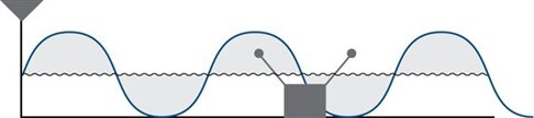

In the diagram below, an RF signal is represented with a simple sine wave, a radio transmitter is shown at the far left, and a receiver is shown near the middle with two antennas: a 'left' antenna and a 'right' antenna. At a given distance from the transmitter the 'left' antenna of the receiver is located in one of the peaks while the 'right' antenna is located in a trough.

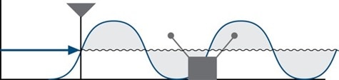

If the transmitter moves, and the sine wave peak moves away from the 'left' antenna, that antenna would see a reduction in any available signal strength. In a single antenna design, the reduced signal level may result in dropped packets or a dropped connection. However if the design incorporated antenna diversity and the second antenna (the 'right' antenna) was positioned at 1/4 wavelength from the 'left' antenna, then the 'right' antenna would be in a new peak. The antenna diversity algorithm in WiConnect would then automatically switch the radio to use the 'right' antenna as the new primary antenna.

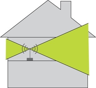

In addition to positioning the two diversity antennas at a 1/4 wavelength apart, it is also useful to consider the radiation profile of the antennas. In the case of a simple whip antenna such as the ACA-4HSRPP-245, a typical profile is similar to that of a donut around the antenna itself.
The donut profile of the whip antenna means that the antenna transmits and receives very well to the sides but does not radiate as well up and down. In a single antenna design positioned with a vertical antenna, as in the diagram to the left, this would create an ideal situation for a particular floor in a building, but would not be ideal for communicating with devices on a higher or lower level floor. image
If that same device was rotated 90 degrees, the performance above and below would improve but the performance to the side would degrade.

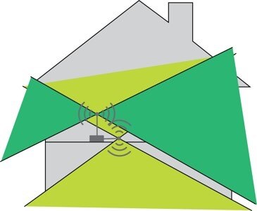

If the device had antenna diversity, using two antennas positioned at 90 degrees to each other, the performance in both directions would be improved.
