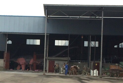

I, Lucy Rogers, was invited to visit an animatronic dinosaur factory in China - the factory that supplies the dinosaurs for Blackgang Chine Theme Park on the Isle of Wight.
The factory is in the "technology" commercial area of the city, which, from the car seemed very like technology commercial areas in the UK. However, not many factories in the UK have a full size apatosaurus (brontosaurus) style dinosaur looming over the workers.
The dinosaur "skeletons" (frames) are welded and assembled on site, then the motors and cables are added:
The skeleton then is wrapped in foam - this starts with big blocks being cut to roughly the right size and shape: imageimage
Highly skilled artists then carve the foam to look like skin / wrinkles / dinosaurs. Once the shape is right, what looks like ladies' tights is stuck to the foam with, probably, a latex glue.
And then, in what appears to be a magic process, a dinosaur appears, ready for some finishing touches. Like teeth.
