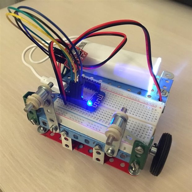

While browsing for construction ideas, I stumbled upon a construction by guys from MikroElectronika: https://www.hackster.io/16283/esp8266-mikroe-buggy-ccd102
So I put out an old metal construction kit I inherited from my father and built a "car" chassis. You can see the result under the original project, in Replications section.
What I like about this construction (I mean the DIY variant, not buying the original kit):
  • easy to build (ca 1 - 2 hours including build the chassis)
  • cheap electronics - ca $10 for the parts, not including power source - my power bank was a giveaway (previously I used 4x NiMH AA battery and a battery holder)
  • cheap chassis - could be made from metal, wood, plastic, maybe even hard paper
  • cheap remote control - I assume almost everyone has a cell phone / tablet with WiFi and HTML5 capable browser
  • easy to expand - remote control software, micro-controller firmware, the hardware - more wheels, sensors, etc.
  • doesn't rely on 3rd party cloud services, registrations, ...
(More images are on the original project page.)
What do you think?

    Thanks, I used a Merkur kit, made in Czechoslovakia (origins go back to 1920), about 50 years old with a few newer parts.
    I had to Google how does an Erector set look like and it is pretty much the same, however the idea is a few years older. What is surprising to me: the first kit of this type was probably a Mechanics Made Easy (nowdays Meccano) from 1901 image
