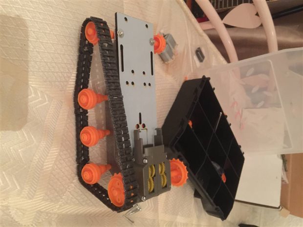

Stage 2: Build the chassis
Now, I could have moved on to more electronics protyping, as I still needed to build the DC motor driver board, but I wanted to break it up a bit, so I thought I would build the chassis.
It came in a useful kit which needed to be assembled:
I decided to start with the gearbox:
And then onto the actual chassis
Now its was time to start playing with the sensors - at this point, its no more than a glorified arduino holder! or a printer decoration image
