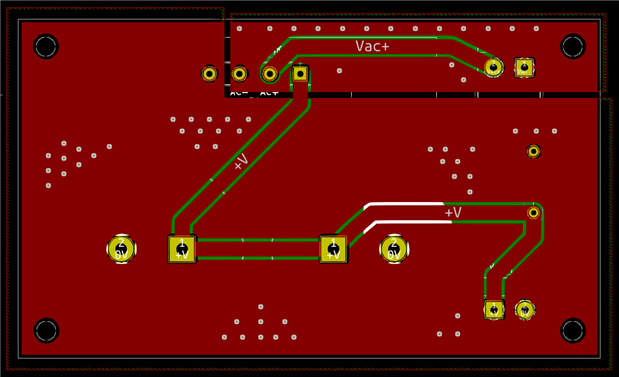

I have produced precisely zero PCB designs before - I don’t count the trial one I did of my first power supply I mentioned in Part One which was faintly praised with ‘It should work electrically” image  This is somewhat more complicated and I've added images below.
I set my own constraints when doing this:
  • follow layout guidance given in data sheets
  • use SMD parts, mostly, to keep the size down.  The exceptions were for parts that I don't own the proper tools to solder.
  • fit within 100mm x 100mm dimensions AND 2 layers to keep production costs down.  JLCPCB will create these at around £1.50 for 5 but the price jumps to £22 for a 4-layer board.
  • allow for 2mm between parts to let me to get a soldering iron in and (hopefully not) a hot-air nozzle if I have to rework it.  I really don’t want to buy one of those yet.
  • not split a ground plane by minimising bottom layer routing
  • take account of current capacity with track widths.
A note on the last point re track widths.  The ‘high current’ path is set at 1.5mm - this is greater than the minimum width calculated according to IPC-2221 for a 10 degree C temperature rise and well over the width required for a 20 C rise which I believe it could easily cope with.  It’s less than the minimum width calculated according to IPC-2152 for a 10 C rise but well over the width for a 20 C rise.  In either case, I couldn’t derive a width by specifying a voltage drop: the calculators didn’t allow it and I’m not sure what an acceptable drop would be as output isn't fixed.  It’s obviously not in line with a rule-of-thumb 1mm per Amp.  Ultimately, I traded off space and size against the real likelihood of extended running at 3A which is unlikely for me: for most operation it will be fine and I expect it will be ok at 3A as well.  Even at a 3A output, there isn't 3A flowing through all the high-current circuit (the LT3081s max at 1.5A for example.)  All other signal paths are well over-sized at 0.5mm or 0.35mm for what is small number of milliamps.

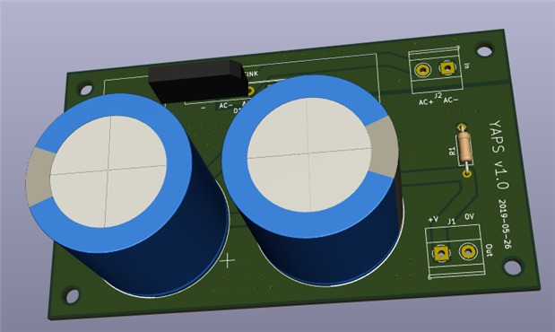

Power Stage PCB
Here's the component positioning and trace routing:
Front and Back planes for ground:
And a 3D view of front.  KiCad doesn't have 3D views for all parts so the terminal blocks aren't showing.  Also, note the bug in positioning of the rectifier:

    Always check the Gerbers! I found a few vias that were a little too close to the traces and intruded - not shown in PCBNew but clear as day in the Gerber. 5 each of the Power Stage and Power Control costs…

    Always check the Gerbers!  I found a few vias that were a little too close to the traces and intruded - not shown in PCBNew but clear as day in the Gerber.  5 each of the Power Stage and Power Control costs under £4.78 from JLCPCB; shipping ranges from £5.50 to £24 depending upon how long one is prepared to wait.
    Pictures from Gerber view - front silkscreen:
    Front copper and solder mask:
    Back copper and solder mask:
    Power Stage silkscreen:
    Front Copper and solder mask:
    Back's not so interesting so I haven't added an image.
