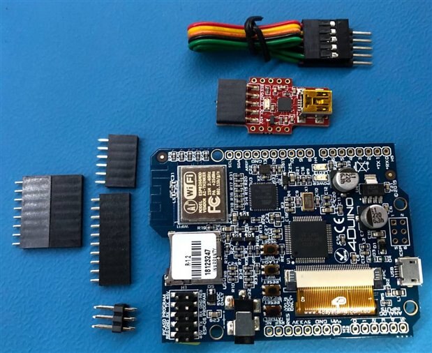

I'm going with an Arduino interface to display voltage, current, power and temperatures.  In the first version this will be display only - controls for setting voltage and current limits are manual (10 turn potentiometers) - but can be extended with more functionality in the future.
The 4Duino from 4D systems is an Arduino compatible (Leonardo I believe) device with a built in touch-enabled LCD, wifi and SD card reader.  It comes in a number of sizes and this project uses the 2.4" version.
In the box we find a number of headers and connectors.  This is the starter kit version: in addition to the module and headers, which come with the standard version, there is also a programming adaptor, a 5-way F-F ribbon cable with M-M adaptor and 4GB microSD card (not shown, I missed it initially in the packaging!)
For prototyping, I just want to get together the code to read thermistors and voltage and current flow.  First things first though, the headers need soldering to the module: they come separately so that you can attach wires directly or different headers (e.g. angled ones) if you prefer - I will be using crimped leads so on they go:
First impressions are really positive: it's well packed and the datasheet is very comprehensive.  It's not a big chore to solder on the headers - about 10 mins work.  A novice to soldering would be advised to take it steady: those headers need to be perpendicular if you want to add a Shield on, otherwise you will struggle to engage the pins.  My suggestion is to hold them against the board with blu-tac or similar to make sure they stay put during the process.  The datasheet has some good instructions.

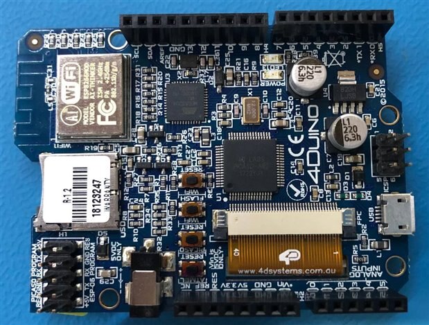

Getting Started
The 4Duino, unlike the Arduino Uno I'm more familiar with, runs only from a regulated 5V supply supplied to Vin, USB port or barrel jack: a diode pair uses the input with highest voltage if there is more than one connection.  On a Uno it seems possible to power the board through the +5V pin as well: that won't work here.  One potential drawback of the board could be that the 5V pin will only supply Vin - 0.3V so if you need to drive a 5V regulated circuit from the board you'd have to sail Vin very close to the wind with it's max input voltage of 5.5V.  Fortunately I don't need to do that.
Your computer's USB port should provide a regulated supply.  If you're connecting to Vin I would recommend that you double check the regulated output first to be double sure it is under the 5.5V limit.
Programming can be done via the Arduino IDE (100% compatible) or 4D systems proprietary IDE, Workshop4.  The latter is only available for Windows so if you are on MacOS or Linux then Wine/Crossover or virtualisation software is necessary.  It's worth thinking about what you want to achieve:
  • Arduino IDE: basic functionality achieved through a Picaso serial library and wifi command set.  For simple interfaces and usage this may be enough and comes with the familiarity of the IDE.
  • Workshop 4: This allows for greater exploitation of the board giving three development environments:
    • Basic graphics: uses native arduino code with graphic primitives. No access to uSD card
    • Extended graphics: a visual programming environment with drag-and-drop graphical objects.  Uses the uSD card to hold the graphics
    • Genie graphics: seems to build on extended graphics with the inclusion of event-driven actions.  Noted as 'coming soon'.
For the purposes of prototyping the display, what I want to achieve is a base-level of code with data written to the LCD.  I'll do that with the native Arduino IDE for now.  Later, I intend to develop the interface further and will be able to comment more on the Workshop4 software (and its compatibility with Wine/Crossover.)
Connecting the 4Duino to my iMac requires a microUsb cable.  Guess what isn't provided in the box?  Guess how many USB cables I have access to and the subset of those that are microUsb?  Fortunately, I have one out of the dozens of cables I have but it's worth bearing in mind.  Frankly, at these prices I think one should be provided in the starter kit.
As far as I can tell, the only way to use the Arduino IDE is as a standalone app - there doesn't appear to be a way to add the 4Duino to the acceptable boards list in the online editor.  Download and install it, add the necessary json file to the board manager - full instructions are on the 4D systems website.  This document provides a guide to using the display in serial mode which is all that is needed here - basically, it's an introduction and a complete set of commands to send to the Picaso processor which handles the screen.

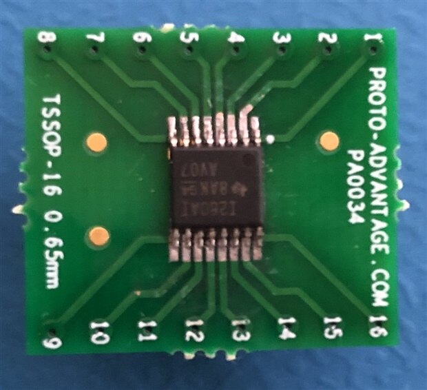

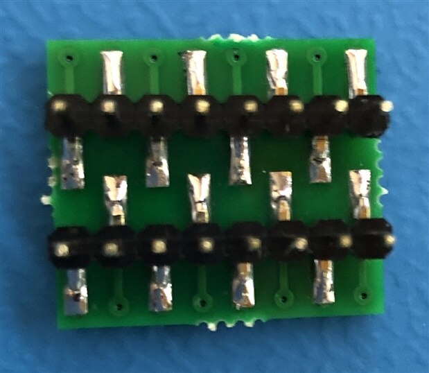

INA260 Adaptor Board

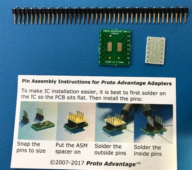

To test the code for Voltage and Current readings I need to solder a TI INA260 IC to an adaptor board - a TSSOP-16 to DIP-16.  Here's the kit from CPC:
It looks like good quality: the headers have two pins on one side as they 'surface mount' to the bottom.  The clear plastic is a spacer to ensure they solder onto the board at the correct distance apart to plug into a breadboard or prototype board.  Post soldering:
I got hold of a SMD flow tip - hoof tip - for my Hakko FX-888D (from Mouser, not available on Farnell), one with a dimple on the tinned surface.  I tried it and failed miserably with it - just too big and I couldn't get it to properly connect with pins and pad and buckets of flux didn't help.  There's clearly a technique to learn as it seems a popular approach.  Anyway, got there with my standard 1.2mm tip.  Testing the pins for bridging I was a bit annoyed to find pins 1,2,3 and 14,15,16 were bridged.  A quick wipe with solder wick and....still bridged.  Then I remembered that these pins are internally connected - I really don't know how I've made it this far!!  After soldering on the headers, it fits in the breadboard and I can verify pin connections and no bridging.

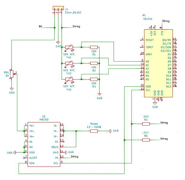

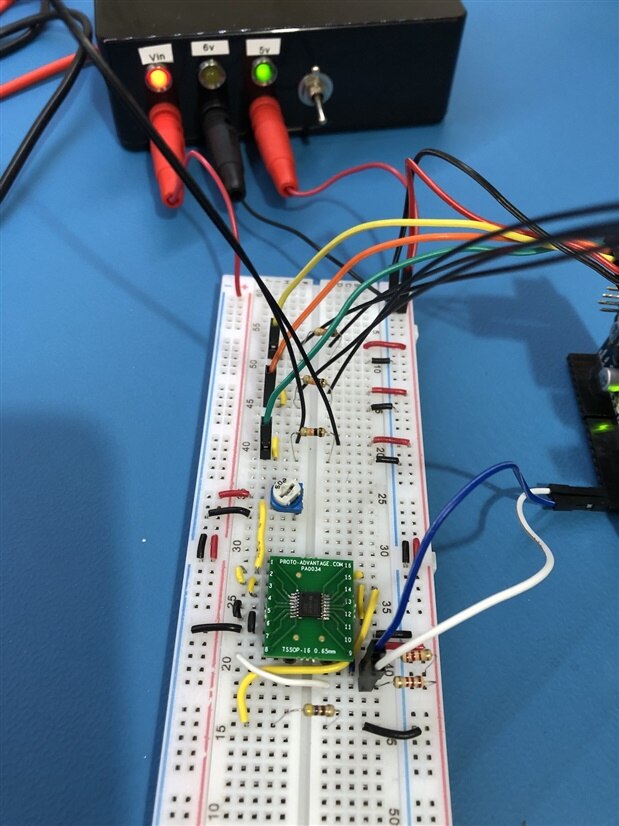

Prototype Schematic
In the build I will be measuring the temperatures of the LT3081s; the bridge rectifier, Mosfet and case temperatures and the voltage and current draw of the connected load through an INA260 IC from Texas Instruments.  The prototype will test all this with breadboard mounted components and the simply power supply I already created (see Post One - Introduction.)  It can provide both the regulated 5V I need plus up to 12V on a separate connection.  Here's the schematic:
The load is a power resistor I purchased for testing purposes - 10Ohm at 100W.  My supply is limited to 1A at 9V and 0.9A at 12V.  I'll run the voltage at 9V with this load.  Changing the load resistor to different values will allow me to manage the current drawn from the supply and I can then increase the supply voltage to 12V.
The breadboard is shown below.  I use red wires to indicate power; black wires to indicate ground and other colours for signal.  I've removed the original image and substituted the one below which includes the INA260 on its adaptor (the substituted one was the same just without the adaptor.)
5V and Ground run down the right hand rail and 9V and Ground down the left hand rail (power on red, ground on black) - ground is linked across the bottom of the breadboard.  I use red for direct connections to a power rail and black for a direct connection to GND; other colours are signal wires.  On the right hand rail, the red and black dupont leads go to the 4Duino Vin and GND to power it.  The yellow, orange and green dupont wires go to A0, A1, A2 on the 4Duino: this provides the input voltage for the thermistors and thus temperature calculation.  The white and blue dupont leads go to the 4Duino SDA and SCL pins - this will allow readings of voltage, current and power.  The yellow lead from the INA260 that snakes around it, leads to the load: in this image a 470Ohm resistor to take the place of the 10Ohm/100W noted in the schematic to make it easier to photograph.  In my testing I will probably make use of different load resistors to measure current changes.
Measuring the actual voltages supplied to the board by my simple supply gives 9.120V and 4.988V.  The 5V actual and for the 10K Ohm series resistors actuals, for the thermistors, are reflected in the code below to improve accuracy.

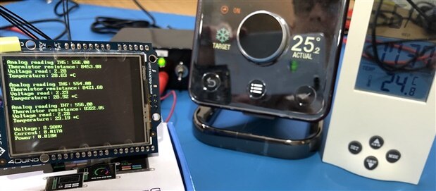

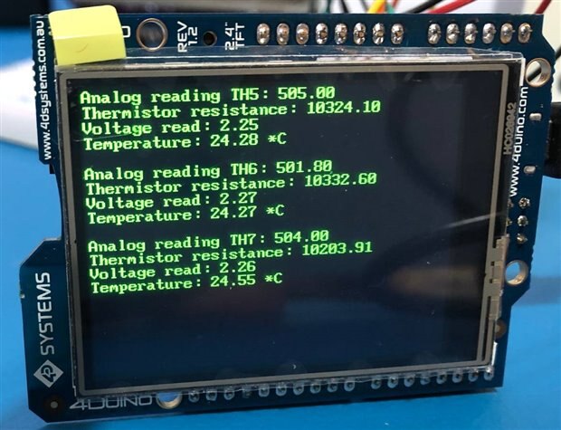

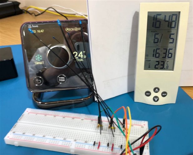

Results (early testing)
Actual temperatures, from two guages are 24.0C and 23.8C.  The images below are from when I was powering the breadboard from the 4Duino rather than a power supply (the 4Duino was powered via USB from my iMac).  I've left them in to show the accuracy that can be achieved this way
The calculated temperatures are below:
It looks like I am within 0.5C which is good enough for monitoring purposes.  I'm hoping I can get this a little more accurate by tuning the voltage and resistances a little more.  Given I can't create a perfect 25C environment for the thermistors, I can't accurately measure their nominal resistances at that temp so for now they stick at 10K Ohm.  A quick test with an external regulated 5V supply driving the 4Duino and thermistors is giving worse results so I need to do more investigation on that - I'm waiting on a couple of parts.  A typical approach would be to power the 4Duino at 5V and power the thermistors from its 3.3V and using that as the analog reference voltage - it's a lot less noisy.  I won't be able to do that in this version of YAPS.

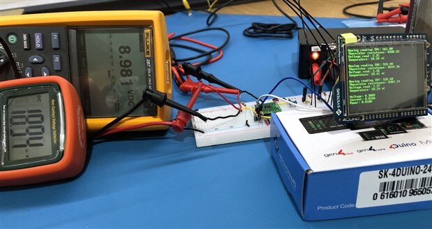

Results (Full Testing)
The readings from the INA260 look pretty accurate when compared against a multimeter:
Sorry, not a brilliant photo but it's difficult to get it all in.  What it is showing:
  1. Fluke is measuring voltage: 8.981V
  2. Extech is measuring current: 18.94mA
  3. 4Duino is showing: 8.998V 0.016A 0.018W
It would be hard to say which is most accurate but the discrepancy is about 10mV and 3mA.  The Power value is way off: clearly something wrong with the code so back we go.
For the temperatures:
This is now reading way off:
  • Hive is showing 25.2C
  • Clock is showing 24.8C
  • 4Duino is showing: 28.83C 28.92 29.19C
I would assume there will be some variation in the thermistors themselves (in the code I've taken account of the series resistors actual resistances and actual voltage supplying them.)  However, the calculated temperature is 4C too high - that I need to improve.  Checking the display resistance against the datasheet, the temperature that is displayed is pretty much correct (for example, 8453Ohms is between 28 and 29C in the datasheet.) Also, if I use the displayed resistances (10000Ohms for 25.2C) with information from the datasheet on this site, it calculates the temperature at 28.48C.  I think the code is correct so it must be the analog to digital conversion within the 4Duino.  Note that it isn't 28C in this room - I think Hive and clock are accurate.  The tips of the thermistors are way above the breadboard as well so unless there is a funnel of rising hot air then they should be at the same ambient temperature as Hive and Clock.
It may be that the regulated 5V I supply is noisy; it may be that the ADC in the 4Duino is being affected by noise from its internals (usually why you can set AREF to the 3.3V supply directly from the 4Duino / Arduino.)  Back to research and the code base.  I have just taken delivery of a DC-DC switching regulator that can replace the LM7805, recommended by shabaz, so I will try that in the circuit.
More to come but I'll post as comments rather than keep updating this post.

    Now we're cooking on gas!
    I've made a few updates to the code to improve accuracy.
    Firstly, the Voltage, Current and Power - the mistake I made initially with the power reading was ignoring the 10mW LSB value the INA260 holds - accounting for that brings it into expectation.  All values have some LSB size to take account of:
    • Voltage: 1.25mV
    • Current: 1.25mA
    • Power: 10mW  I suppose I could just take the Voltage and Current values and work out the power myself, save a read etc.
    The Fluke is measuring Voltage; the Extech Current.  What we are seeing:
    • Fluke: 5.4840V
    • Extech: 11.44mA
    • 4Duino: 5.488V; 0.009mA; 0.050mW reported (against a P=VI calculation of 0.049mW)
    I'd say that was pretty good!  2mA of current off.  The datasheet for the INA260 states it has a 5mA offset maximum and a current sense gain error of 0.2%typical to 0.5%max.  That wouldn't count for it all but I'm also measuring that current through 2" of hookup wire.  It's accurate enough.
    Secondly, the temperature readings.  I was right in that the culprit in the inaccuracy was the nominal 5V Vin on the 4Duino.  That's used as a reference in the analog reading conversion: if it isn't precisely 5V then the conversion is off.  Even providing it with a regulated 5V supply isn't going to give that level of accuracy and it will always fluctuate somewhat.  In fact, the voltage supplied is a few 10's of mV lower than 5V causing the analog reading to go high - hence the higher temperature readings displayed.
    Here's what I show now:
    • Hive is showing: 22.6C
    • Clock is showing: 22.1C
    • 4Duino is showing: 22.26C; 22.78C; 22.33C
    I can definitely live with that accuracy!  I made two changes to the code.  Firstly, when taking the analog reading I also took a Vcc reading using the ATMega32U4 internal voltage reference of 1.1V.  I then used that reference to accurately convert the analog reading into a voltage reading.  This bypasses the conversion using the 5V 'perfect' supply.  Secondly, although minor, I changed the Steinhart Hart calculation to use a more accurate equation incorporating coefficients from the datasheet.  I've only used those applicable to a range of 50.5C to 103C and could squeeze a little more accuracy by including the range from -2C to 50.5C but I don't think that's necessary: I think a fraction of a degree discrepancy is accurate enough, will always be subject to the actual resistances of the Thermistors (which I can't be bothered to calibrate) and it's impossible to say which of the 3 Thermistors, Hive and Clock are the correct reading in any case.
    You'll also notice that the display shows a Control Temperature: this is actually a specific resistance taken from the datasheet and pushed through the calculation to make sure it was accurate - the answer for 8766Ohms should be, and is, 28C.  As an aside, Excel calculated it out at 26.somethingC which led me down a lot of pointless cross-checking.  There's something screwy within its calculation I'm sure - possibly the logarithm function.
    I'm really happy with that.  The final display I want to incorporate graphics and the like but I now have something to test the build against.
