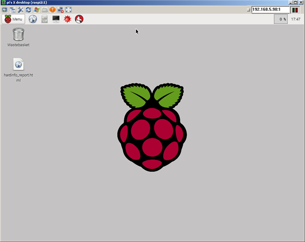

  We are almost there so stay with me. In order to run full screen, we need a VNC server and a VNC client. The server code was downloaded before when we installed tightvnc server code. It is the most widely used because it is small foot print in memory and fairly responsive. To start, we will need our SSH window into Raspberry Pi 2. Look above if you need to re open. Enter the following:
image    tightvncserve :1
image    You will be prompted for a password. This is not the Raspberry Pi 2 password, but one you will use below for client connection. It is 8 characters in length.
image     Repeat exactly what you typed in previous set to verify.
image     Another password for view only. I hit enter to skip!
image     You will get a few lines showing you are done. Save these by selecting and copy. Later paste into a safe place in case you need them.
    This command will start a background program to "listen" for any attempt to run VNC service on port 5009. If this sounds strange please re-read the networking above. Next step we can download on Windows 7 a program called UltraVNC. You can find a download at UltraVNC | SourceForge.net. Read very carefully before downloading so you understand the process. When we open the UltraVNC Viewer on Windows 7, we get a small window:
image    VNC Server: 192.168.5.90:1
image    Click Connect button on right side
image    A window prompting you for password:
image      This is the password you set for TIGHTVNC SERVER and not the Raspberry Pi 2 password!
image    See new window open looking like this:

    johnbeetem over 11 years ago in reply to clem57
    Clem Martins wrote:
    Any standard ethernet cable will work. The physical connections have a circuit to reverse the signals when necessary. Funny thing but I have not needed a patch for a long time.
    Most Ethernet ports nowadays (including RasPi) have Auto MDIX.  The port automatically switches the transmit and receive pairs and figures out which way works.
