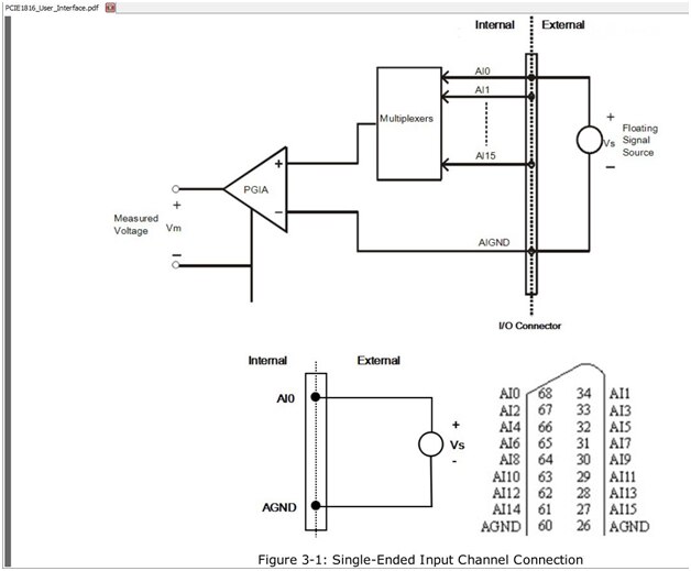

After mounting the PCIE-1816 DAQ board in the computer and installing the DAQNavi software I started with a simple measurement of a DC voltage source.  First I had to configure the inputs of the DAQ board, and I found quite useful the “PCIE1816_User_interface.pdf” document, in which I found “visual” diagrams showing how to connect signals to the DAQ board inputs, like the example below:

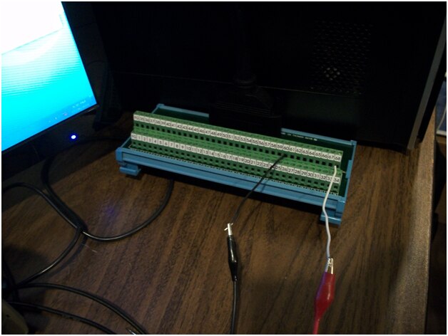

Based on this diagram I connected my voltage supply to AI0 at pin 68, and I used pin 60 for ground:

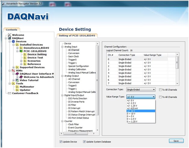

I then opened the DAQNavi input setup panel and I set the input voltage range on channel 0 to +/-10V:

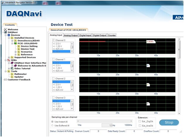

I then used the DAQNavi transient graph window to display the 6V dc input signal, as shown in the screenshot below:
Notice the red trace in the upper graph that started from the left side and moved towards the right as more samples have been recorded.  The built-in cursor function shows 5.9V, which is close to 6V considering also the visual approximation of me aligning that cursor with the signal trace.

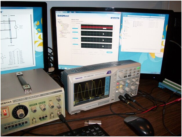

After measuring this 6V dc signal I moved towards more advanced measurements.  Next, I measured a sinusoidal signal from a function generator, as shown in the test bench picture below:

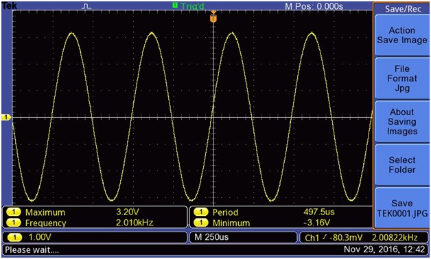

I have also used an oscilloscope to visualize the signal applied to the DAQ board.  The signal displayed on the oscilloscope is shown in the picture below:

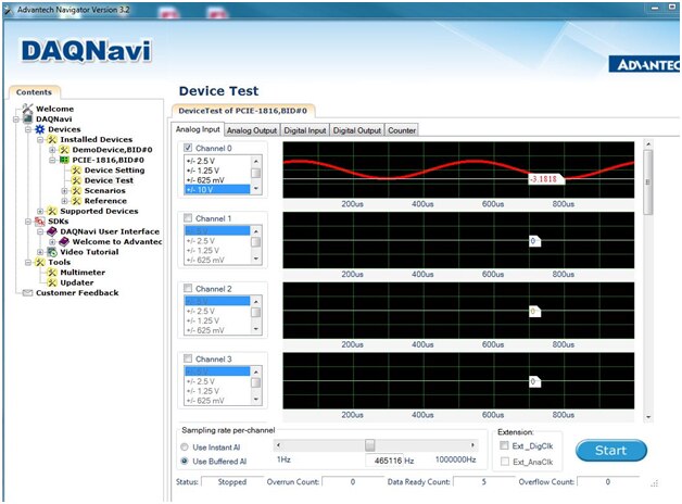

And the same signal measured with the Advantech 1816 DAQ board and DAQNavi software is shown in the picture below:
Comparing the DAQ card measured waveform with the oscilloscope waveform, the sinusoid period is 5 x-axis divisions of 100us/div on the DAQNavi graph, close to 497us on the oscilloscope.  The low level is -3.18V on the DAQNavi graph close to 3.16V on the oscilloscope.  The upper level is 3.18V on the DAQNavi graph, as shown below,
which was close to 3.20V on the oscilloscope.

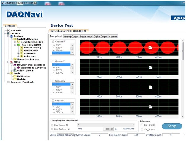

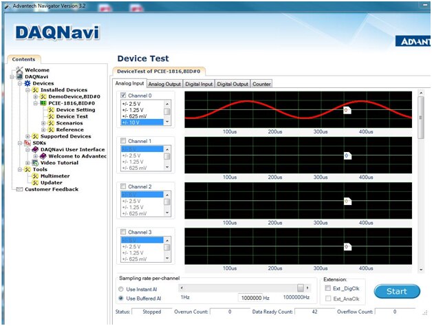

I then increased the frequency to “push” into the Nyquist sampling rate.  So the max sampling rate of the 1816DAQ card is 1Ms/s, so I increased the generator frequency to 500kHz.  At this setting I ran into stability issues, since it looked like the generator could not keep a constant 500kHz frequency.  By manual continuous adjustment I could temporarily maintain 500kHz, like in the screenshot below:
But most of the time I couldn’t, so my sampled waveform looked like this:

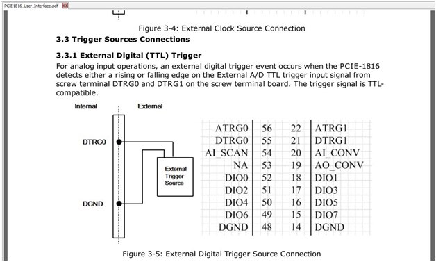

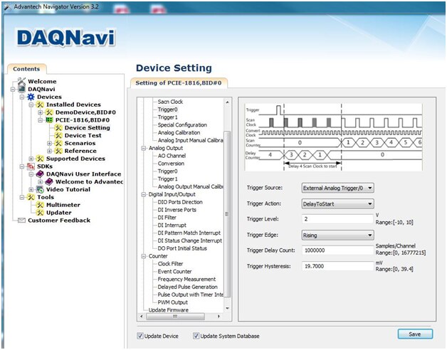

Next I evaluated external trigger functions of the Advantech 1816 DAQ card.  Again, I found very useful the “PCIE1816_User_interface.pdf” document, which shows in simple to quickly understand the connections for external analog and digital trigger:

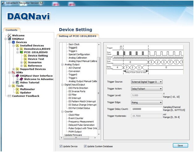

The rest of trigger settings I have done in DAQNavi settings panel, which uses a great graphical interface to quickly show how the trigger works and what each setting means.  The panel for setting the digital trigger is shown in the screenshot below:
And for the analog trigger:

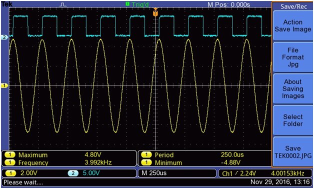

I have looked at various waveform frequencies and trigger settings; here is one example with digital trigger:
And the corresponding input signal (yellow) and trigger signal (blue):

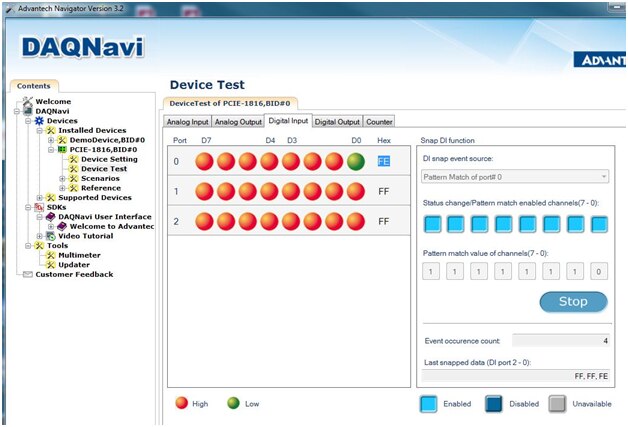

After finishing the measurement of analog signals I looked into measuring digital signals.  The DAQNavi software has a nice graphical interface for displaying the logic state at the digital inputs, and which has a pattern matching feature.  In this experiment I toggled bit 0 of port 0, so the input pattern changed from 0xFF to 0xFE (hex representation).  I opened the DAQNavi settings panel and I setup the pattern recognition to look for 0xFE pattern:
With these settings I then turned on my frequency generator and the DAQNavi software started to display how many matched patterns have been recorded:
Notice the “Event occurrence count” = 4 (and it kept going up as more bit toggling occurred).

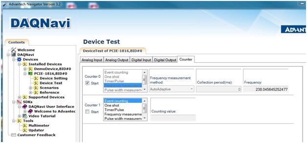

Next I setup the 1816 DAQ board counter to measure the frequency of a digital input signal.  The counter can perform various other measurements like: event counting, one shot, timer/pulse, pulse width.  In this experiment I chose to measure the frequency of a signal provided by an external frequency generator.
Here is the DAQNavi measurement panel:
The measured frequency was 238Hz, and the same signal frequency measured with the oscilloscope was also 238kHz, as shown in the picture below:
