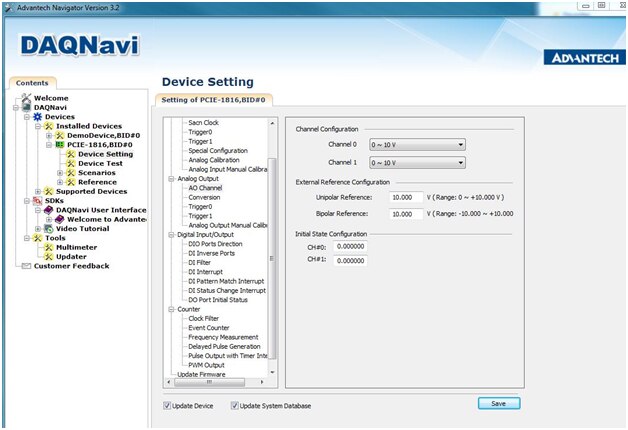

I started by first setting up the voltage range of the analog outputs using the settings panel of the DAQNavi software program:

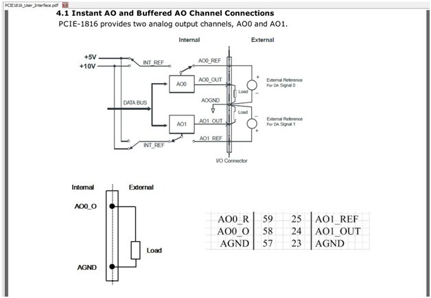

I have setup 0 – 10V voltage range on both channels, 10V reference, and 0V initial state.  Next I opened the “PCIE1816_User_interface.pdf” document and I looked for instructions on how to connect the analog outputs.  I like this document because it explains clearly and visually all I need to setup my test bench experiment:

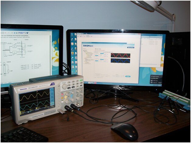

I then connected an oscilloscope to the two analog outputs at pins 24 and 58.  Here is a picture of my test bench setup:

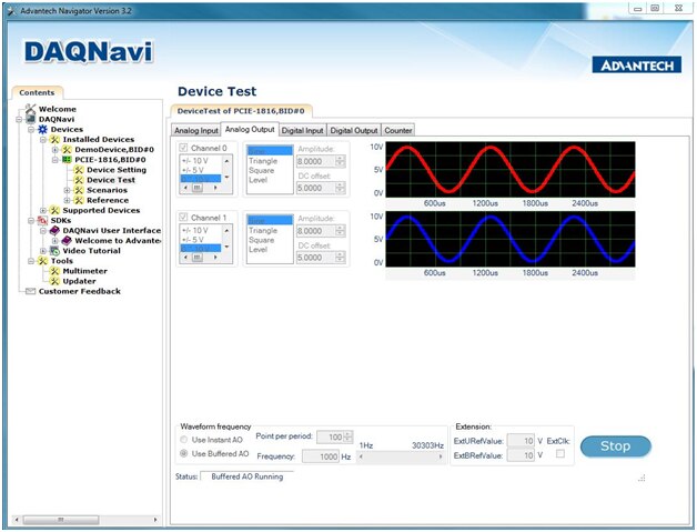

I then setup sinusoidal signals at both channels using the DAQNavi waveform setup panel:

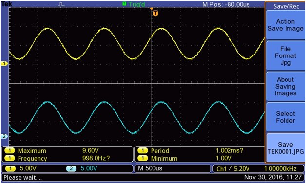

The sinusoidal signals were set to 1kHz frequency, 5V common mode, and 8V amplitude.  I then clicked the “Start” button and I checked the generated waveforms on the oscilloscope:
The displayed waveforms show 8.6V amplitude, 5V common mode, and 0.998kHz frequency, close to the settings in the Advantech 1816DAQ board.  Looking at the screen I see channel two sinusoid of 8V amplitude (based on 5V/div setting) and channel one sinusoid slightly higher amplitude, which is also measured with the built-in measurement functions.

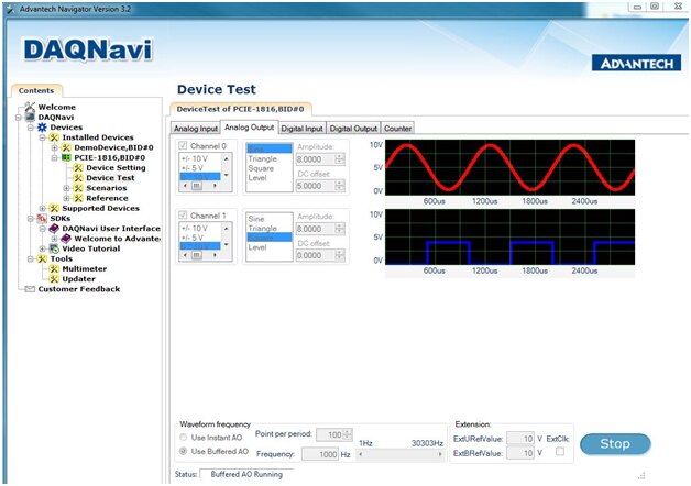

Next I changed channel 1 of the Advantech 1816DAQ board to square wave signal, but I didn’t pay attention to the common mode, which remained to the 0V default.  When I looked at the oscilloscope screen I noticed only 4V amplitude on the square wave signal instead of 8V:
I then realized my mistake, which was actually shown also in the graph window of the DAQNavi settings panel:

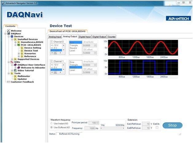

Notice the blue waveform chopped at 0V, so even though I setup 8V in the amplitude field the displayed waveform showed what signal will be generated.  I then adjusted the common mode to 5V and the DAQNavi settings panel graph showed me the full 8V amplitude square wave:
The oscilloscope waveform matched the programmed one:

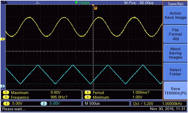

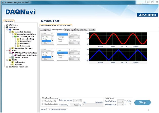

Next I changed the square wave into triangular waveform, also of 8V amplitude and 1kHz frequency:
The oscilloscope displayed these two waveforms as I was expected:

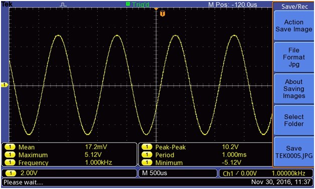

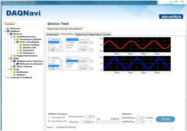

Following these experiments I focused on a single sinusoidal signal starting from 1kHz and gradually increasing the frequency until I reached the maximum that the DAQ board could generate.  I have also set the voltage range to +/- 10V and the common mode to 0V.
I have tried to enter higher frequency values, but the DAQNavi panel always displayed the 30.303kHz, which is the maximum frequency that I could generate with this board.  The waveform on the oscilloscope looked like an ideal sinusoid:
The measured amplitude and frequency came close to what I have programmed in the DAQNavi settings panel.

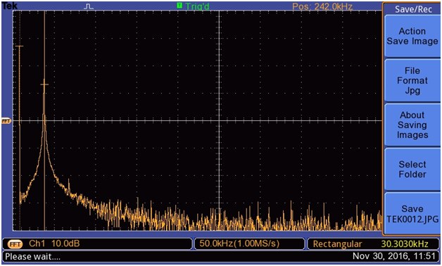

This waveform looked like a perfect sinusoid, but to further analyze the “quality” of this sinusoid I setup the oscilloscope to measure the FFT of this signal:
I was impressed of the quality of the generated sinusoidal signal.  The fundamental frequency was measured as 30.3030kHz, which is exactly what I have programmed in the DAQNavi panel.  There were no significant spurs and visually I could see that the phase noise is quite small compared to other oscillators that I have seen.

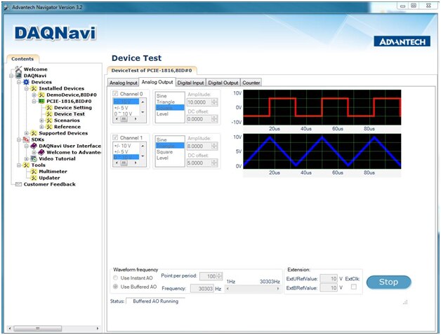

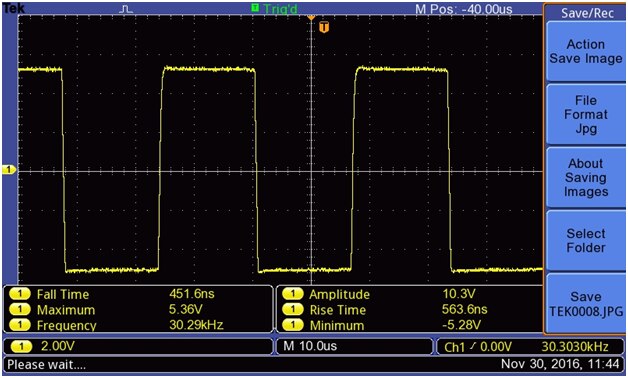

Next I switched to a square wave signal also of 30.303kHz frequency:
The oscilloscope displayed this waveform:
The measurements of frequency and amplitude were close to what I have programmed.  The oscilloscope also measured the rise time and fall time.  For 10.3V amplitude a rise time of 563.6ns (10%-90%) results in a slew rate of 14V/us, and similarly for falling edge 17V/us.

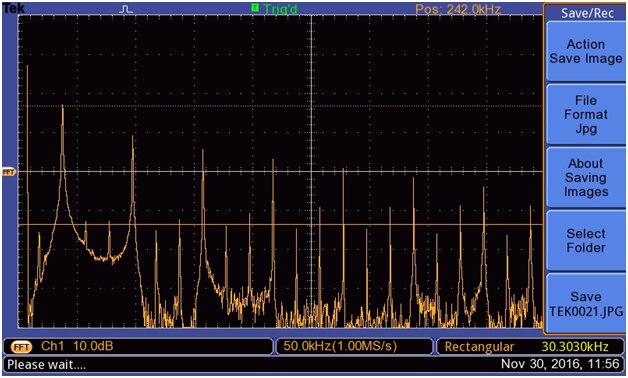

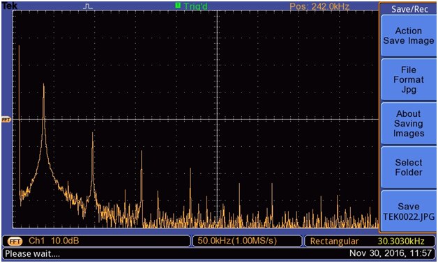

The FFT of this signal looked like an expected FFT of a square wave signal:
The fundamental is at 30.303kHz, exactly what I have programmed, and the harmonics are as expected for a square wave signal.  I also wanted to check a triangular signal, and that FFT is shown in the picture below:

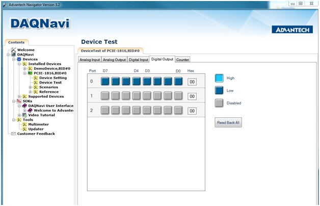

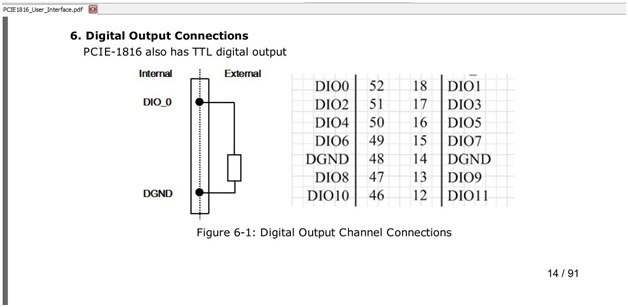

Next I generated digital signals.  I first opened the “PCIE1816_User_interface.pdf” document, in which I looked for how to access the digital I/Os of the DAQ board:

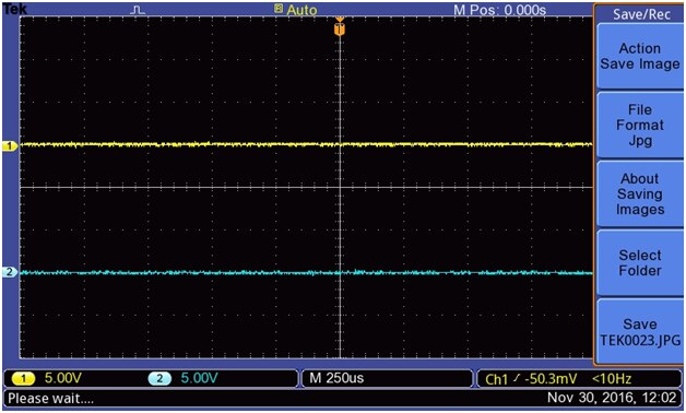

So to generate digital signals I first had to configure the I/Os in output mode, and then I opened the digital output control panel in which I could toggle outputs by just clicking on corresponding buttons of the software panel. Here is the panel with all outputs set to 0V (logic “false” or low level):
The oscilloscope showed 0V level on D0 and D1 outputs:

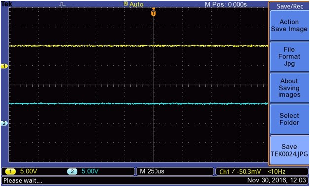

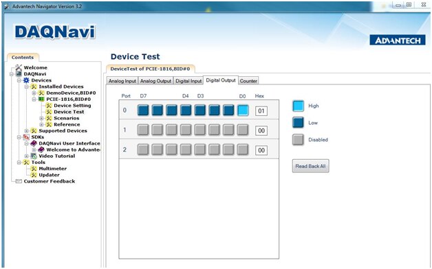

Next I toggled D0 in the DAQNavi panel:
And the oscilloscope showed D0 signal going to 5V (logic “true” or high level).  Next I toggled D1 also, so both D0 and D1 were generating 5V, and I checked again the oscilloscope waveform:
I have checked various other combinations and all performed as expected.
