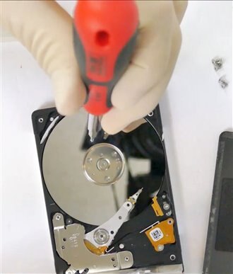

A few months ago I purchased a 2.5" 2 TB USB hard disk drive mostly for backup, but I started using it for project work that had lots of video in it. A few days ago it wouldn't power up with my computer - it just made an intermittent beeping sound. After some research I decided this was probably a situation where the heads got stuck to the disk. I haven't seen any complete analysis of why or how heads get stuck to disks, but here is my speculation: Heads normally stay in their parked position beside the disk until the disk is up to speed. When the heads launch onto the surface the boundary layer of air at the disk surface, travelling with the disk, forces the heads to fly a few nanometers above the surface using something like wing-in-ground-effect. To counteract the lift force the heads must be pushing down due to a weak spring, because they can operate on their side. If the disk stops spinning while the heads are above its surface, the heads will contact the surface, because the lift force of the air disappears. There is about 1 nm of lubricant on the disk surface, which allows a perfect air-tight seal of the head to the surface, so air pressure clamps the head to the disk just like a suction cup. On a small disk like the one I have this air pressure creates enough friction to prevent the small motor from spinning the disk. There must be some smarts in the disk that senses an overload and intermittently tries to restart, hence the beeping sound.
Hopefully the heads got stuck just as the disk stopped rotating and didn't scratch a groove in the disk. The following video shows my attempt to dismantle the disk drive and un-stick the heads. I'm not recommending anyone else should or shouldn't do this, it is just a story of what I did.
This procedure worked perfectly for me. The disk fired right up and I immediately copied all files to another disk - about 1 TB of data.

    The thing is that stiction doesn't really achieve its maximum adhesion "immediately". Very often, if it's a perfectly clean disk and the heads have only rested for a very short period, the drive may be able to get going again. But left (unknowingly) for a while, changes in humidity and temperature with the constant downward pressure of the head suspension would keep it in its place, slowly "welding" it to the surface and potentially damaging the diamond-like coating.
    Instead, torsional shock when the drive is attempting to spin up might give enough of a momentum boost to break the heads free. Then, resting on a "fresh" surface, it would not be as well adhered. Better yet, if the spindle motor is also giving a kick at the same time - now you need to overcome the coefficient of kinetic friction (assumed to be lower), rather than static friction thus the drive should get to speed enough for the heads to start flying on its own.
    Of course, slapping, shocking the drive etc is not intended to get the heads loaded back onto the ramp - merely break the temporary "welding" of the heads to the surface for just enough for the static friction to be overcome.
