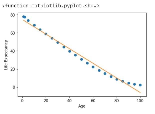

plt.xlabel("Age")
plt.ylabel("Life Expectancy")
plt.plot(age, lifeExpectancy, 'o', age, model)
plt.show
A couple of points about this exercise:
  • The data is not linear but I will use a linear fit.  It is also possible to fit a polynomial or other curve to the data.
  • In real life with such a simple set of data we would probably use a table and interpolate.
I ran 2000 epochs, but the mean squared error had settled by 1500.
And here is the resulting straight line regression in yellow plotted along with the blue data.
So, again this is not a particularly useful example other than for understanding how to create a regression model.  One thing to be aware of is that models like this can get stuck on local minima and thus not minimizer error.  I need to look into that some more.
