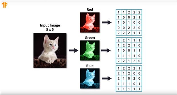

Color RGB images have 3 channels:  Red, Green, and Blue.  They can be represented in a 3 dimensional matrix as shown in the much simplified slide below taken from the Udacity course.

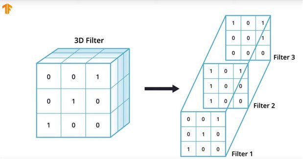

For a color image a 3D filter (aka kernel) can be defined in a similar manner to what was done for grey scale but with 2D filters for each channel.
The convolution is then applied to pixels channel by channel.  The sum of each filter is added for the pixel and a bias, typically 1, is added to make the convolved output.  The edges can be padded as shown in the example below.
It is common to use more than one filter on each channel.  In this case the convoluted output is multi-dimensional with the depth equal to the number of filters.  In the example below the depth is 3.
While training the model, the filters are updated as the training progresses to minimize the loss function.

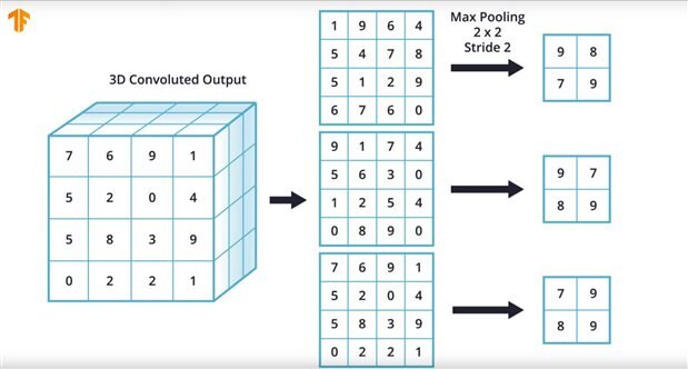

Max pooling is also used and works in a similar way to grey scale.  In the example below a 2x2 window is moved across with a stride of 2 which downsizes the 4x4x3 matrix to a 2x2x3 matrix.

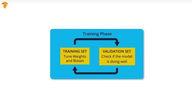

In the previous models a test dataset was used to determine how well the model worked after training is complete.  A validation dataset checks how well a model is doing as it completes each epoch.  Note that the model does not use the validation dataset to modify the weights and biases.
Validation allows us to develop a model that is accurate and general without overfitting.  Since the model architecture and variables can be modified to better fit the validation dataset it is still necessary to have a dataset since the modification can develop a bias.

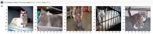

The models are getting more complicated in the training now and lengthier but conceptually are similar.  To keep my posts a reasonable length I will bypass much of the code and direct you to the Udacity course instead.  The first 5 images in the training dataset are shown below:
Note the squished images, partially covered images, busy backgrounds and foregrounds, kitten, and unusual stance of the dog.  For general classification a large and varied dataset is required.

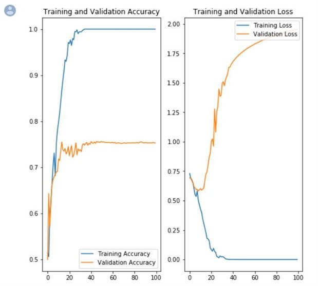

To demonstrate overtraining, 100 epochs are used.  The resulting accuracy and loss obtained with each epoch is shown below for both the training and validation sets.
The training dataset reaches an accuracy of 1.0 (complete memorization) around epoch 20.  However, the validation dataset reaches a maximum of 75% and does not improve further.  In fact, the model was overtrained well before epoch 20.
