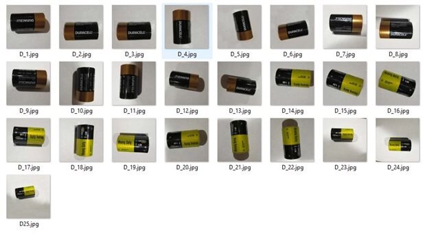

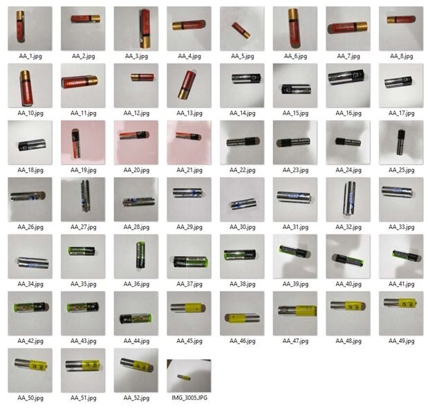

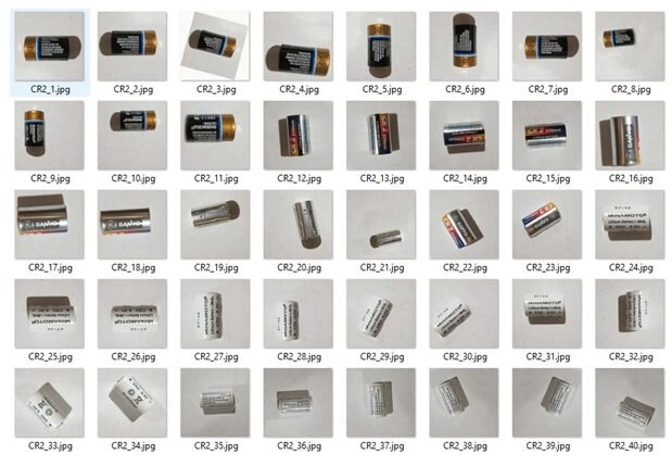

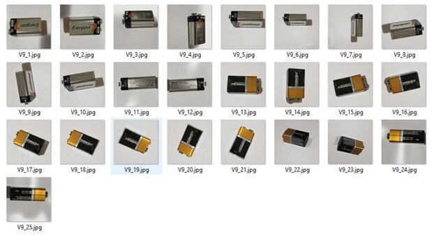

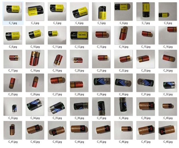

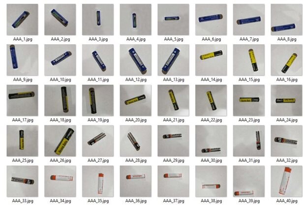

Gather Images
The following is only covered lightly in the Udacity course.  Gathering the images can easily be the most time consuming part of the exercise if they aren't already in a carefully collected and massaged set.  In this case a dataset will be developed from "scratch" - that is I will take the photographs myself and prepare them.  When collecting images keep the following in mind:
  • Larger photos (i.e. more pixels) can give higher accuracy but there is a trade-off with speed.  I haven't found much improvement in the images I have examined with more than 150 x 150 pixels although that could vary depending on the subject.  The photos used here were resized to 200 x 200 in Photoshop and then resized again to 150 x 150 in TensorFlow.
  • Bigger datasets are better for generalized recognition - e.g. 1000 images or more for each class.  However, I am interested in small datasets and what can be done to make them accurate even if they are less general.  The classifications in this set vary from containing around 25 to 50 images.
  • Lighting, background clutter, partial view, centering, rotation, size, etc. can all be important in the training set, especially for generalized recognition.  As an example, in this dataset I have attempted to "fool" the AI by varying size of objects in the images which have the same aspect ratios.  To gain more accuracy this would be avoided.
The dataset consists of images taken of various batteries that were on hand.  They were taken with an older model Canon PowerShot S95 camera hand held in poor lighting but with a clean background.  Camera angle was varied and the batteries rotated and turned to get varied views.  This is not a good dataset for training for any number of reasons but I may build on it and in any case wanted to use my own set for educational purposes.  The images used were placed in separate folders by class as follows:
AA Batteries
AAA Batteries
C Batteries
CR2 Batteries
D Batteries
9V Batteries
Note that since AA and AAA batteries have similar aspect ratios and I have not kept the scale constant we can expect the model to have trouble with them.  The C and D batteries might have the same problem where the battery brands and markings are very similar.  My prediction to start was that the model would not be very accurate.

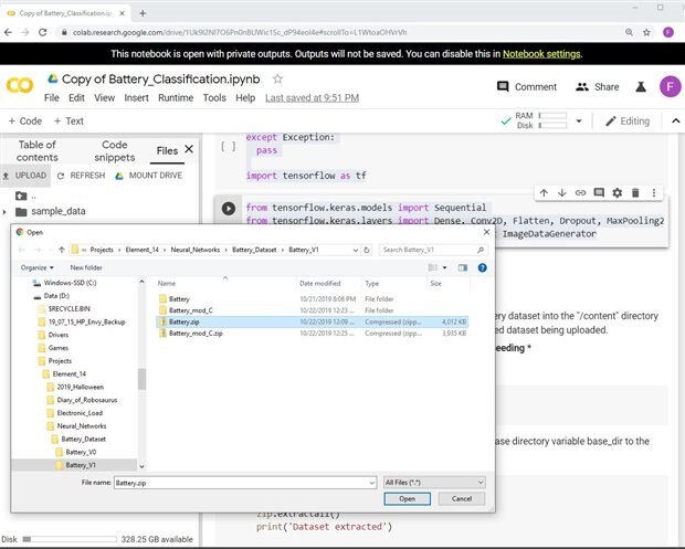

Data Loading
The portion of the following which covers uploading files from your computer and extracting them is not covered in the Udacity training.  First, zip all the files for uploading.  The file structure used will be outlined further below.  Then select the "Files" tab in Colab which will expose an upload option.  Click on it and upload your dataset (in this case Battery.zip) as shown in the screenshot below.
You will get a reminder that uploaded files are deleted at the end of a session.  This means they will have to be reloaded every time a new session is started.  Wait for the download to finish before proceeding.  The status is indicated lower left and this can take a while.  Press refresh and the zip file will be visible. The dataset is then be extracted with the following code.
from zipfile import ZipFile
file_name = "Battery.zip"
!pwd
with ZipFile(file_name, 'r') as zip:
  zip.extractall()
  print('Dataset extracted')
!ls
base_dir = '/content/Battery'
When run you should see that you are in the /content directory, that the dataset has been extracted, and that the following files / folders are present:  Battery, Battery.zip, sample_data.  Battery.zip is the file we uploaded and samples_data is a folder with Colab samples.  The folder that we want is Battery and as noted above it contains 6 battery classes in folders:

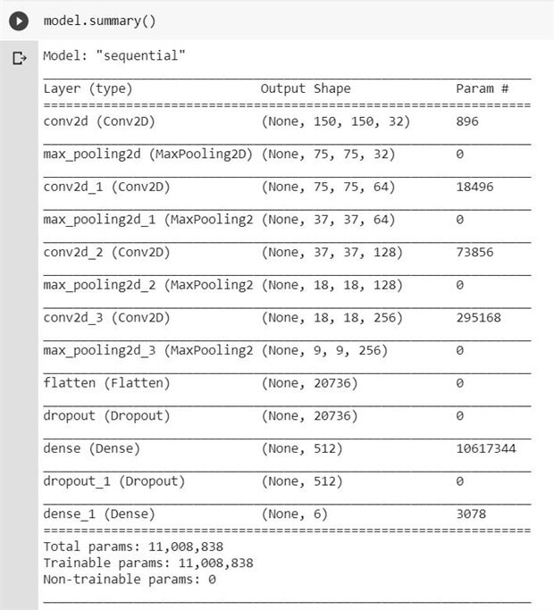

Create the CNN
We are finally ready to define our convolutional neural network.  The architectural decisions we will be making are the number of layers, the number of filters, and the size of the filters.  They are quite important and I am quite sure what I am presenting here is suboptimal. Typically the number of layers starts small and grows as the complexity realized by the convoluted layers grows.  The number of filters in a layer should be set at ratios of 32, 64, 128, 256, 512 and so on according to one source.  Perhaps this is to better suit the GPU or TPU.   In this case I have elected to make four convolutional layers with succeeding filter sizes of 32, 64, 128, and 256.  I tried some more complex models with more layers and filters - that actually made things worse.
Remember that filters have odd values since they need to be centered on the pixel being convolved.  A 3x3 filter is usual although larger ones of 5x5 up to 7x7 may work better on larger images.  Max pool layers typically have a pool size of (2, 2) and are applied after each convolutional layer.
After flattening I chose to set dropout to 0.05.  I played with this and set it at values up to 0.5.  It seemed poorly behaved (validation loss jumped all over the place) at higher values.
The model was given a single dense layer with 512 neurons with activation set to 'relu' as usual.  The number of layers and neurons in the dense layers are important but I did not tweak the in this example.  The number of output elements is always set to the number of classes and activation to 'softmax'.
model = Sequential()
model.add(Conv2D(32, 3, padding='same', activation='relu', input_shape=(IMG_SHAPE,IMG_SHAPE, 3)))
model.add(MaxPooling2D(pool_size=(2, 2)))
model.add(Conv2D(64, 3, padding='same', activation='relu'))
model.add(Conv2D(128, 3, padding='same', activation='relu'))
model.add(Conv2D(256, 3, padding='same', activation='relu'))
model.add(Flatten())
model.add(Dropout(0.05))
model.add(Dense(512, activation='relu'))
# Set output layers to number of categories
model.add(Dropout(0.1))
model.add(Dense(6, activation='softmax'))
A concise model summary is obtained with the following code.
model.summary()
Note that over 11 million parameters are being trained.  I have some concern about the model being overcomplicated.

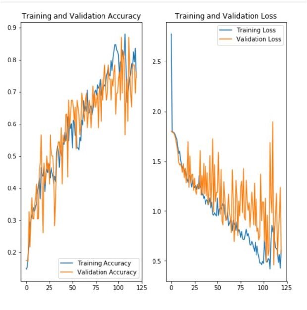

Analyze the Output
The following code plots the training and validation accuracy / loss graphs.
acc = history.history['accuracy']
val_acc = history.history['val_accuracy']
loss = history.history['loss']
val_loss = history.history['val_loss']
epochs_range = range(epochs)
plt.figure(figsize=(8, 8))
plt.subplot(1, 2, 1)
plt.plot(epochs_range, acc, label='Training Accuracy')
plt.plot(epochs_range, val_acc, label='Validation Accuracy')
plt.legend(loc='lower right')
plt.title('Training and Validation Accuracy')
plt.subplot(1, 2, 2)
plt.plot(epochs_range, loss, label='Training Loss')
plt.plot(epochs_range, val_loss, label='Validation Loss')
plt.legend(loc='upper right')
plt.title('Training and Validation Loss')
plt.show()
The moment of truth...
The training dataset seems pretty well behaved and steadily climbs to about 85% accuracy at 100 epochs.  After that things get a bit rugged in both the training accuracy and the training loss.  The validation accuracy is pretty jagged (maybe due to such a small dataset?) but tracks the training set and peaks around 80% and epoch 100.  It is possible to get 100% accuracy on the training set if the number of epochs is set high enough (i.e. it can memorize the dataset).
I am actually quite pleased and a bit surprised with the accuracy of such a small dataset that was purposely made difficult.
