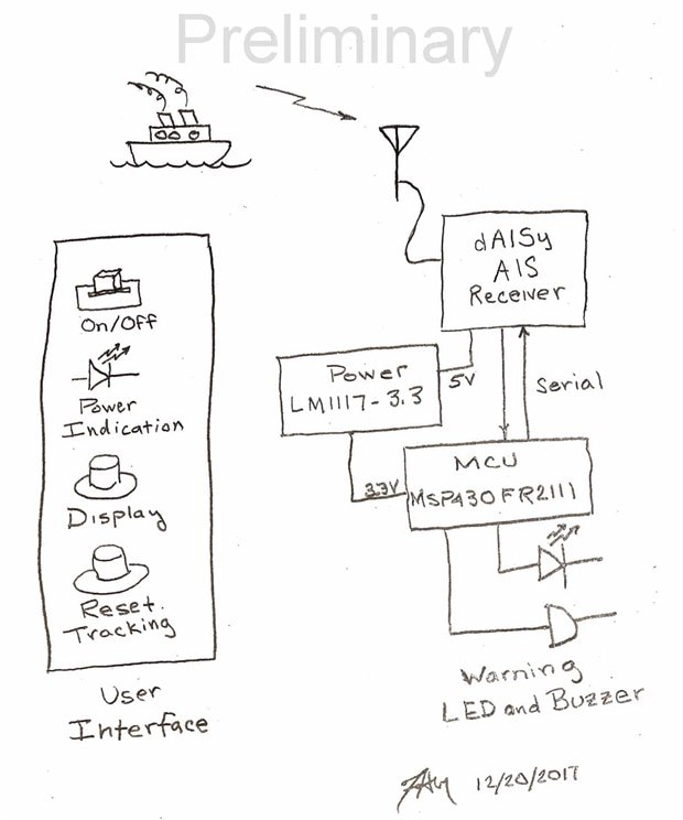

Project Objective: Develop an open source AIS Alarm that alerts sailors that a new marine vessel with AIS is within range.
I have been experimenting with the Texas Instruments MSP430FR2xx microcontrollers and have selected it for a project I have been thinking about for a while.  The objective is to develop an open source AIS Alarm that alerts sailors that a new marine vessel with AIS is within range.  AIS (Automatic Identification System) is a tracking system for ships that gives information on among other things location, direction, and speed.  It is required on vessels of 300 or more gross tonnage and all passenger ships.  Below is a cartoon of what I have in mind:
The real magic is the open source AIS radio receiver dAISy.  I have used them for a couple of projects.  There are also dual channel and Raspberry Pi hat versions.
I intend to power the dAISy module with a USB power stick like the ones sold for cell phone recharging.  This will allow it to be disconnected from a laptop which is the way I normally power dAISy and thus reduce power / lengthen the life of the laptop battery.  dAISy has serial output and a 5V terminal.  This will be used to power a MSP430FR2111, a buzzer and a LED which will be placed in an enclosure with the dAISy receiver.  When a new vessel is detected the AIS signal will be entered into a ring buffer in FRAM and the alert issued from a buzzer and flashing LED.  The dAISy can then be unplugged from the power stick and plugged into the USB port of a computer running OpenCPN or other suitable navigation software.  There will be a button on the user interface that will squirt the AIS information (which is still there since we are using FRAM) over to the laptop so that the vessel can be located on the screen.

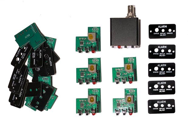

Update 17 June 2018:  Here is a photo of the first "production run" of the version 1.0 boards.

    mcb1 over 8 years ago +4
    Sounds like a great concept. The big issue you'll have is getting it commercialised, since vessels of that size are not pleasureboats and will be subject to various regulations. Commercial ADS-B units…
  • BigG
    BigG over 8 years ago +3
    Interesting project. Having personally been at the helm of a yacht while crossing the English channel at night during a storm and almost being run over by a ferry, I can see great value in this. However…
    jw0752 over 8 years ago +2
    Hi Frank, This is a great project with important application. I like your use of the recharging power stick as I too have found these very useful in providing poratble power to some of my project plus…
    mcb1 over 8 years ago in reply to fmilburn
    The potential user of this would be a DIY type who doesn't have the money for a commercial version
    Ahh that makes perfect sense then, and yes I agree it would be particularily useful as a secondary system.
    I also like the idea that it sends an alert whenever something is within xx metres.
    In theory that should make it capable of being standalone, with a display to prove it's working.

    fmilburn over 8 years ago in reply to jw0752
    Hi John,
    Thanks for the encouragement.  I have used the recharging power sticks for a couple of projects now and they are really handy.  I thought about building a Li-ion battery and charging into the project but decided to keep it simple at least for now.  I have run into two problems with them in the past however:
    1. I ordered some cheap ones from the usual suspect sources that failed quickly.  Wouldn't want to be relying on those...
    2. One of my larger ones has a circuit that turns itself off if the power requirement is below some preset level and the USB cable has to be unplugged and plugged back in again to get it going.  Not good for a low power project or one that sleeps...

    fmilburn over 8 years ago in reply to BigG
    Agreed.  The person who suggested this originally sails alone in relatively low traffic waters.  He just wanted something that would warn him if he was on autopilot and below deck making a sandwich or taking a nap.
    I think your idea for an alert transmitted to deck is a good one.  The dAISy module has provision for Bluetooth but I don't know how widely it is used.  I had mine connected to a CC3200 for a while before I put together an Ethernet version.
