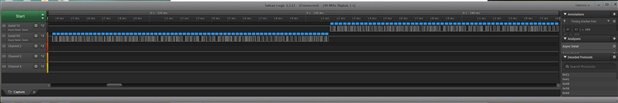

The logic analyzer was set up to read both incoming and outgoing activity on the prototype.  The entire incoming and outgoing NMEA messages from the prototype cannot be fit into one window in the logic analyzer and still be read.  But the following screen shot shows the two sentences compressed and further checking shows a perfect match.
This is real progress.  Now to set up the ring buffer and see if memory is looking sufficient to store the desired 16 messages.
