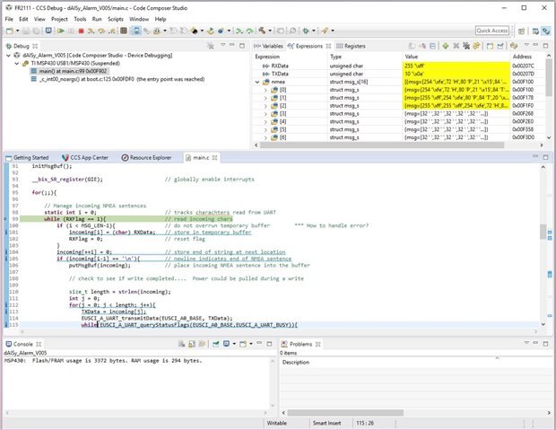

The prototype is now receiving AIS messages from the dAISy module.  In this post a method for storing the messages in a persistent FRAM ring buffer will be described.  This is important to the project because persistent storage means the messages will not be lost when the device is unplugged from power.
The screen shot below taken from the CCS debug view shows that 1) the ring buffer is being updated with AIS messages, and 2) that FRAM usage is 3372 bytes which gives confidence that the MSP430FR2111 will have enough memory for the job at hand.
The highlighted values show the variables that have changed since the debug window was last paused.  It indicates that 3 messages were received.
