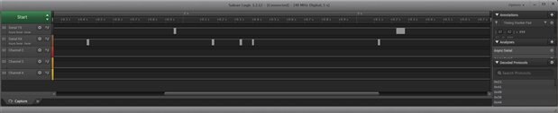

The following screen shot is a demonstration of the current state of the firmware.  It shows the incoming messages (RX) from dAISy on the second line of the logic analyzer.  When the display button is pushed, output of what is stored in the ring buffer (TX) shows up on the top line.
The first series of blips on the second line is a single incoming message from dAISy.  In this case the ring buffer was empty when this occurred.  The next series of blips is on the top line and occurred when the display button was pushed.  Closer inspection shows it to be identical to the message just received.  The ring buffer was emptied during the output.  Following that are four blips on the second line that represent four more incoming AIS messages.  When the display button was pushed the second time these four messages came out together on the top line, again identical to what was received.
