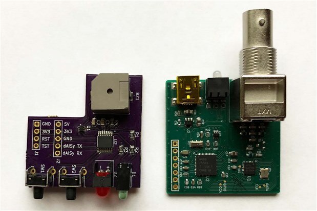

Over the weekend the remaining parts arrived and I finished populating the board.  I found a few more problems and will document them here.  Normally I don't document problems unless they are somehow unique and instead give the final state but for this project I am going to publish warts and all.
Here is the populated board next to a dAISy receiver.  The completed design will fold like a book over the dAISy with ribbon cable between the boards and slide into the aluminum case.
There are several problems which must be fixed along with a couple enhancements I intend to make in the next PCB:

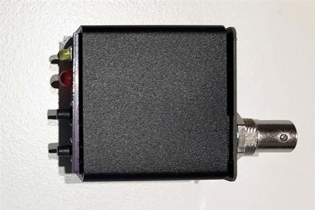

  1. Interferences - One of the buttons is too close to the case and prevents easy sliding.
  2. Interferences - The space between the dAISy header and one of the LEDs on the alarm PCB is tight.
  3. Interferences - The buzzer and the dAISy LED interfere when in the case.
  4. Footprint - I used the wrong footprint on the large red LED (this really irritates me).
  5. Footprint - I used a standard footprint for the dual NPN MOSFET which made it hard to hand solder.
Regarding issues 1) through 3) I did not model in 3D but instead eyeballed everything and tried to measure by holding up a rule and working from data sheets.  I expected to make some adjustments but will end up making some big changes to accommodate the buzzer in the layout.
I was in a hurry when I submitted the board and issue 4. was easily preventable.  The pitch of the NPN MOSFET in issue 5. makes it difficult to solder anyway and I ended up having to clean up bridging on both sides.  A stencil and reflow oven would solve this, but I may just go with larger components in future designs.  LESSON LEARNED RELEARNED:  Haste makes waste (and delays).

    fmilburn over 8 years ago in reply to genebren
    Hi Gene,
    Thanks for comments...
    It is a SOT363.  I had two problems - I used the default footprint in KiCad and the pads barely extend past the pins themselves on the package.  I used a toothpick to place solder paste on each pad but got too much.  I used a SMD rework station to flow the solder and there was bridging which I removed after several attempts with flux and an iron.  I believe it would have been easier if I had longer pads to pull the solder back on.  It always bothers me when I have to go back and reheat parts several times...

    genebren over 8 years ago
    Frank,
    Looks like things are coming along nicely.  Sure you were rushing and made a few mistakes.  We have all done that.  It is the desire to see your project come to life that prompts us towards a little haste from time to time.
    On you dual MOSFETs, are those SOT563/SOT666/SSMINI6 packages?  Those things are almost impossible to solder.  I had to swap those out for some SOT363 parts which were still tricky, but way easier than the SOT666.
    Good luck on your layout reworks.
    This photo shows the impact of the interferences:
    The slight *** is caused by the button being to close to the case.  The interference between the buzzer and USB keeps the PCBs from sliding all the way without forcing.  It may not look like much but will require a new layout to fix.
