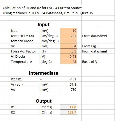

  • fmilburn
    fmilburn over 7 years ago in reply to shabaz
    Hi Shabaz,
    I set up a spreadsheet to calculate R1 and R2 and input the values you determined empirically (nice tests by the way).  Here is an example of input and output:
    Note that the calculated R2 / R1 is 7.8 and not the 10 from the datasheet.  I got pretty close to these values by using two resistors in series:
    R1 = 15 + 2.2 = 17.4 measured
    R2 = 100 + 33 = 134 measured
    I started with the diode I already had in the circuit, IN4148.  I measured the current through it to be 4.23 mA and the voltage drop to be 687 mV which is lower than the Vf your diodes are showing.  The  current out Iset (which ideally would be 10 mA) was 9.83 mA.  I plan to redo the calculations for the actual Vf and / or change out the diode but thought I would post this in case I don't complete it tonight.
    Since it is sensitive to Vf and maybe other stuff, I will try a trimmer pot to see how well that works also.
