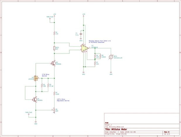

    I have played around with the instrument amps I have and settled on the MCP6N16 with 100x gain.  This has the advantage with a 10 mA current source that the voltmeter displays the resistance directly in ohms.  Here is the schematic:
    7 October EDIT:  The schematic above has an error - emitter and collector backwards on Q2 - will be corrected in the next version...
    Comments are very much welcome - including the way it is drawn if I have deviated too far from accepted norms.

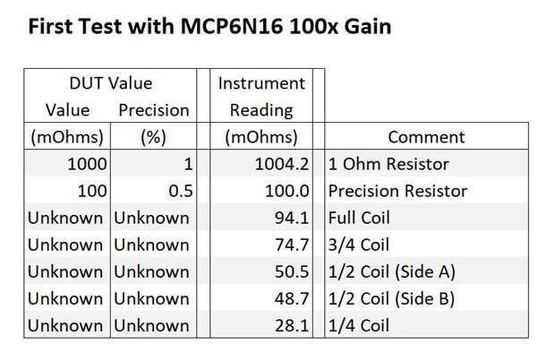

    I have it on a breadboard right now and here are the results of the tests run so far:
    The two known resistors are right on.  Great!
    The "full coil" is the same coil of 26 AWG wire I have used for testing all along and the results are just a bit more (94 Vs. 92 milliohms) than I got with the 100 mA test reported in the main blog above but within margin of error since it is sensitive to how well it is seated in the breadboard and such.  I was pretty excited - the agreement would be expected if everything was done right - it is just that I don't always do everything right :-).  The thing to note is that the results start to deviate from expectation as the resistance drops - e.g. we expect the 1/4 coil to be 94 / 4 = 23.5 milliohms - not 28.1 milliohms.  There are problems with the test setup being on a breadboard of course so perhaps to be expected.  Along with the resistance in the board and jumpers, the contact with the 26 AWG wire isn't always great.  I have wiggled the wire to get the best contact.  None of the resistors on the instrument amp or current source are precision.  Comments on getting better accuracy for lower resistances are also appreciated.

    Hi Frank,
    That's a very clear, neatly laid out diagram! I'm excited that it's all coming together.

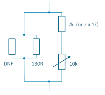

    I just had a non-essential suggestion (there are many ways to do this), maybe instead of the 100R pot in series, it could be in parallel, like this as one example:
    The reasoning was that the 130 ohm resistance is an E24 value, so easy to get in a low ppm version, but is close enough that the trimming can then be easier. Then the other resistors and the trimmer do not need to have a low ppm rating, and (if I've done the sums right) would still allow for trimming to 127.1 ohm at about one-third position of the potentiometer, and a total adjustment span of around 5 ohms from near-fully anti-clockwise to near-fully clockwise. The 'do not fit' position could be useful if a 130 ohm value is not available, and then two different resistors could be used in parallel to achieve that. Anyway, this is a non-essential change, but it might make the trimming a little easier, especially with a 1-turn pot, although a multi-turn would be better maybe, e.g. the bourns ones are fairly low-cost.
