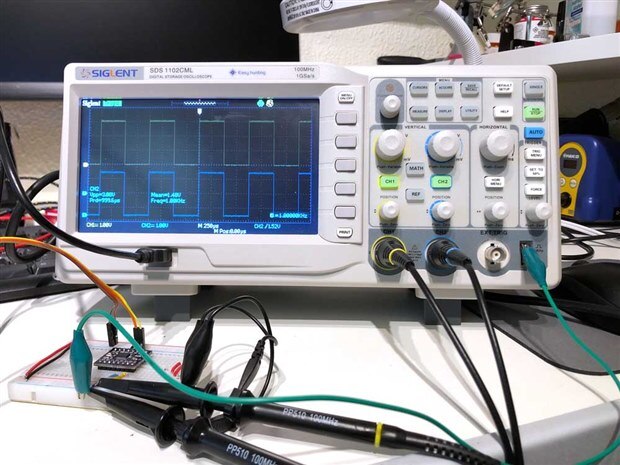

In the setup below the oscilloscope is providing a 3V internally generated square wave at 1000 Hz as input to the op amp on the FR2311.  The blue trace on the bottom is the input and the yellow trace is the output.
Let's have a closer look at the rising edge.  In the photo below the output has been superimposed on the input.  Major divisions on the time scale are 100 ns and the major divisions on the voltage scale are 500 mV for both traces.
The rise time on the output is about 1 us with a bit of overshoot.  So if I am interpreting this right the slew rate is about 3V / us.  I set the mode to "low speed" in the code so it would be interesting to set it to "high speed" and see what happens to slew rate.  Since my application will be DC amplification this isn't too important.
