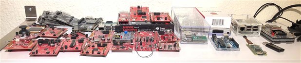

    Fred27  wrote:
    TI's Launchpads come out so quickly these days it's hard to keep up!
    My collection of LaunchPads and other microcontrollers and SBCs sitting on the shelf.  I can't help myself with the LaunchPads.  Still, it is far from a complete collection.
