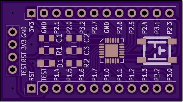

Accordingly, last night I put designed a stripped down breadboard friendly breakout board for the QFN MSP430FR2433 package.  It has a LED, a momentary switch, programming header, and access to all the pins.  Everything else but the switch is 0805.
I modified the TI recommended footprint by slightly lengthening the pads.  The large pad in the center of the QFN footprint is for mechanical and thermal purposes - it is not connected to a network.   In a week or two I will find out whether I can solder a 0.5 mm pitch QFN by hand.  I will also try doing one with my inexpensive rework station...

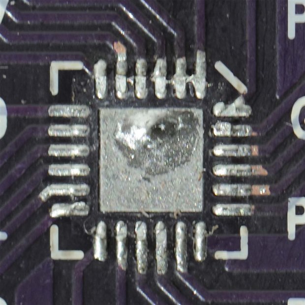

Finally, confirmed the problem and got it fixed.  Thanks to shabaz and mcb1 for suggestions and tips on the issue.  I tried photographing the nonworking board in good light with the FR2433 QFN attached and unfortunately could not see the problem.  I also dug out the finest tips I have and looked for shorts with my multimeter - found a short between TST and RST. I decided to get the hot air rework out and removed the offending part. This is what I saw:
There are a couple of problems here...
  • There  is a solder pool on the center pad - I clearly did not wick enough of it away.  There was also a tiny bit of solder on the underside of the QFN part that I had to wick away.
  • There is bridging on the top row of pins.  This was under the QFN part and I could not see it in photographs or with a lighted magnifier.
  • I scraped so hard on the pins when trying to pull solder back from possible bridges with my iron that I scraped away solder mask.  This was done before I removed the QFN part and usually does the trick for me with a TSSOP part.
The bridging is particularly bad because one of them is across the TST and RST pins as noted above.  No wonder the IDE couldn't recognize the microcontroller.

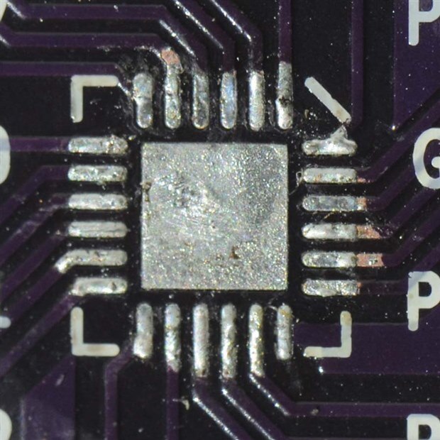

So, I tried wicking away solder again.  Here is the result:
It looked better but I actually made one more pass with the wick before soldering it down.  To solder I applied flux with a pen and then heated it for a bit without the FR2433 QFN on top.  Then I placed the part and straightened it with the tweezers and gave it some more heat.  And for good measure I pressed on the top of the package near the end of the heat cycle to make sure it was seated.  I noted that this part does not self align with just the hot air reflow.  But now, at last, it works and here it is...
Working MSP430FR2433 Breakout Board
Lesson Learned:  Persistence paid off but at least for me, I need a stencil and a better means of reflow when working with QFN parts.  And fresh paste probably wouldn't hurt.  My limit for hand soldering seems to be TSSOP parts when it comes to packages.  The pins, which stick out on TSSOP packages, make it easier for me to test as well as make a connection by hand.
