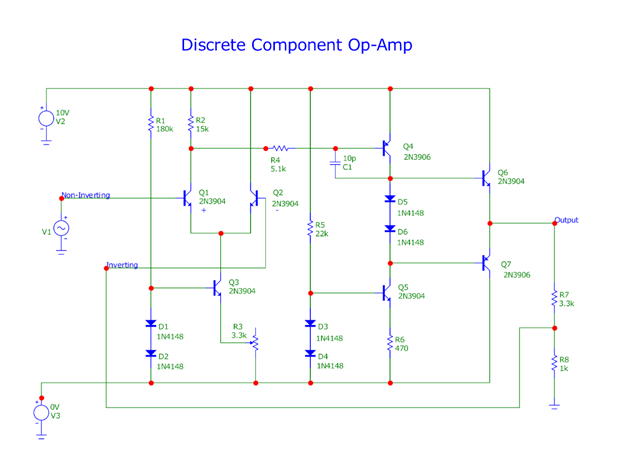

The Schematic and Operation

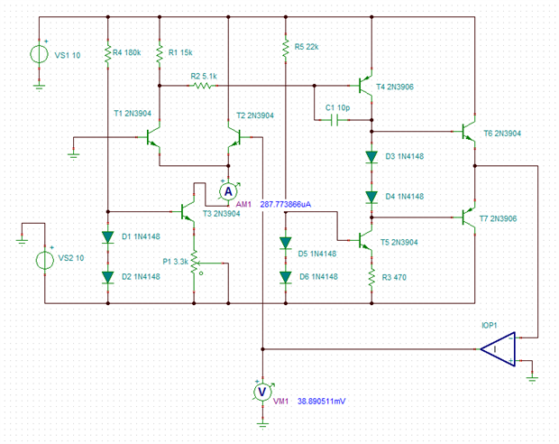

A schematic for the op-amp that was built is shown below.
This is essentially the same op-amp made by IMSAI guy although I am using different diodes and transistors.  Roughly, my brief interpretation of the way it works is this:
Difference Amplifier: R2, Q1, and Q2 make up a differential amplifier - the heart of the op-amp.  Since the total current through the two transistors is fixed by the tail current as described below, a difference between the voltage of the non-inverting and inverting inputs (the base of Q1 and Q2) results in different collector currents in Q1 and Q2.  The base to emitter current vs. voltage curve of the transistors look like a diode.  Once the base voltage of the transistor is high enough to turn it on the current shoots up quite rapidly and small differences in ideally matched transistors mean large differences in the amplified current between the collector and emitter. In an ideal situation with the current fixed and the voltages equal on the non-inverting and inverting inputs the current through Q1 and Q2 will be identical.
Look first at Q1, the non-inverting input.  If the base voltage of Q1 rises the voltage drop across R2 will also increase since the current increases.  In the extreme case all of the current passes through it.  If voltage rises on Q2 the opposite occurs and the voltage drop across R2 decreases.  The varying voltage is then passed on to the amplification stage described below through resistor R4.
Tail Current:  R1, D1, D2, Q3, and R3 make up a current source.  Diode D1 is approximately equal to the voltage drop from base to emitter on Q3. It follows that the voltage drop across D2 will be approximately equal to that across R3 which sets the current through Q3.  As a first approximation the current is 0.7 V / 3300 ohms = 0.2 mA.  A low current is desirable because an ideal op-amp has infinite input impedance and no current flows through the inputs.  In this case the base current will be less than the collector to emitter will by a factor of the gain in the transistor or as a first approximation 200 uA / 100 = 2uA.
A 10 turn, 10 k resistor is used instead of a fixed value for R3 in order to trim the op-amp in the circuit.
Another Current Source:  D3 and D4 form another current source with Q5 and R6. This time the current source will be on the order of 1.5 mA.
Frequency Compensating Capacitor:  There is capacitance in any circuit (especially this one on a breadboard) and this can cause among other things oscillations.  Capacitor C1 allows the designer to select the critical frequency and thus control the frequency response of the op-amp.  It also reduces oscillation.  The critical frequency is 1 / 2*pi*R2*C1.  Given that my op-amp is on a breadboard this calculation is probably way off.
Capacitor C1 also sets the slew rate.  When there is a voltage step between the inverting and non-inverting inputs it drives one transistor into saturation and the other into cutoff.  Capacitor C1 then begins charging or discharging.  The voltage therefore does not change ideally but instead increases or decreases exponentially.  The slew rate is defined as the maximum rate of output voltage change and is the fastest response the op-amp is capable of.
If the voltage swing the op-amp is trying to achieve for a sine wave is too great at a given frequency then distortion occurs and the slew rate may be such that the peak voltage is not obtained.  The maximum frequency the op-amp can operate without slew-rate distortion at a given peak voltage is called the power bandwidth.  Higher power bandwidth is achieved at lower frequencies.
Amplification: Q4 and Q5 act as an amplification stage with very high gain.  Diodes D5 and D6 bias the class B push-pull amplifier which follows.
Class B Push-Pull Emitter Follower:  Finally Q6 and Q7 are a class B amplifier which give the final output.
Non-inverting Amplifier:  R7 and R8 are external to the op-amp and are used to set gain for a non-inverting amplifier with negative feedback.

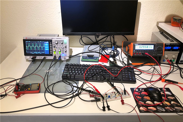

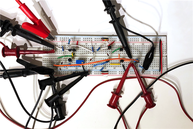

The Setup and Bread Board
The circuit was built on a breadboard and shown below.  My bench power supply has a single channel so +Vcc was arbitrarily set to 10V to begin and -Vee is 0V.  The input comes from the Keysight DSOX1102GDSOX1102G oscilloscope which can provide a DC or an AC signal with DC offset.  The oscilloscope and several multimeters are also used to analyze circuit behavior.
Here is a closeup of the breadboard.  All resistors were 1% and the transistors in the difference amplifier were matched using an inexpensive "M Tester".  The measured beta of the NPN transistors was 210.  The PNP transistors beta measured 189.

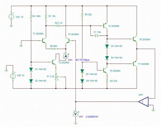

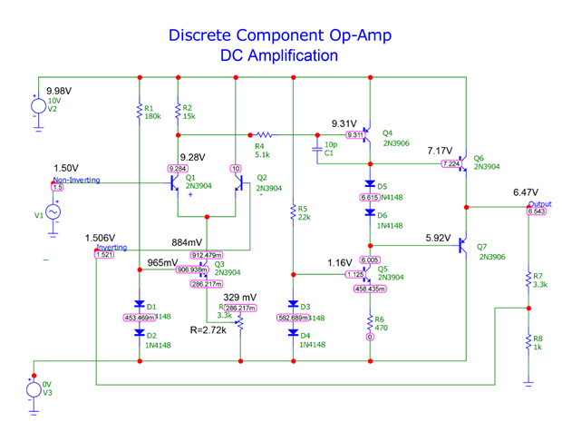

As noted above a SPICE model was set up and was run beforehand.  The gain was set with resistors R7 and R8 to be approximately 4.3 to give an output voltage of about 6.5.  This is about as close as the op-amp can get to the rails.  In the SPICE model below the voltages at nodes is in green surrounded by red ovals and the actual measured voltages are in black in a larger font.  For example, the model was set to give a positive rail of 10V and the measured voltage was 9.98V.
I made an error or two and then had to wiggle wires to get it to work due to a bad breadboard connection but then it became quite stable and as can be seen the results for DC amplification are quite close to the model.  The resistance of R3 (the potentiometer) was adjusted to minimize the voltage difference n the inputs which is why it is at 2.72k instead of 3.3k.  The internal measurements match the model well and gain is right on with reasonable voltage offset after adjustment.  I was quite pleased.

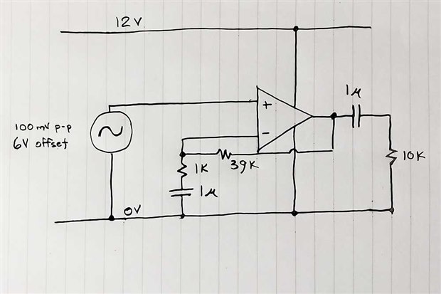

AC Performance
To understand the AC performance the circuit was modified as shown below which passes the AC and removes DC.  The gain was increased to 38.

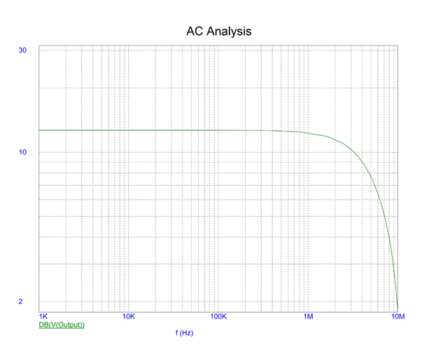

When the circuit was modelled in SPICE the following output was obtained:
This analysis indicated that the bandwidth of the op-amp is around 1 MHz under the test conditions.  As shall be seen the performance is not so good on the breadboard.  All that stray capacitance and who knows what. In the following video the behavior near the rails, influence of capacitor C1, slew rate, and bandwidth are demonstrated.

    I've made one. Not sure why, but I have. Here it is sitting on my battered copy of Walter Jung's cookbook:
    Didn't have enough 2N3904s, so I used BC549C for the NPN and BC559C for the PNP. The BC parts have about twice the
    gain of the 2N devices, so my open-loop gain will be higher than Frank's. [Simulation gives around x15k.]
    Other difference is that I couldn't find a 10pF, so it's got an 8.2pF on it. I have both input-pair emitters
    connected together, so no attempt to trim the input voltage offset.
    To test, I've wired it as a follower with a light 10k load to ground on the output. Here's what it does with a small
    step [the noise is coming from my cheap-and-cheerful function generator]. Yellow is input, blue is output. The
    offset is about 50mV. Rings a bit on the step, but there's enough margin to keep it stable.
    Here's a large step. This shows the slew in both directions.

    Very cool.  I still get excited when something real behaves as predicted.  Even after nearly 50 years of engineering. And your build is way better than anything on a breadboard. Why does the Opamp output take a little jog up before slewing down in the large step screenshot?
  • jc2048
    jc2048 over 6 years ago in reply to fmilburn
    I'm not clear on the reason. Because it's a loop, it's quite hard to pin down.
    The simuation gives something similar, so it's down to intrinsic properties of the parts and not parasitics.
    This is the collector of the input transistor [bottom of the 15k resistor].
    You can see how it starts to move and then the fast sudden edge pulls it in the wrong direction until it recovers and
    gets to where it's going. That's during the period that the transistor is starting to turn off and the pull-up is taking
    over. So one theory might be capacitive coupling through the transistor base-collector capacitance. But the
    interaction that's going on between the two input transistors at that time complicates matters because it would
    introduce effects from further back round the loop. Not sure how you'd determine it physically, but it should be
    possible to work it out from the simulator by systematically changing properties of the devices and seeing what
    the resulting effects were.
    Yes, it's the base-collector capacitance of that input transistor. The model from the library had 3.49pF for it.
    If I set it up for 3 steps from 3pF to 9pF with nothing else changing, this is the result on the output waveform:
