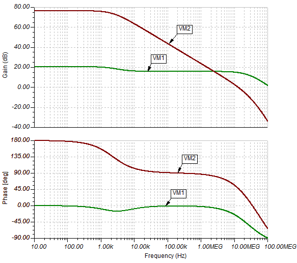

    This is what I'm seeing in the simulator for the open loop gain. The low frequency gain is about 76dB. A 741 would be 100db (x100k). A precision op amp might be several million. The red line is input to output. The green line shows the gain from the differential pair. The pair have some gain [in this case x10], but it's quite low. As you pointed out, the bulk of the voltage gain is coming from the common emitter stage.
    The phase response nicely shows the effect of the compensation capacitor. It holds the phase at 90 so that when we reach the point where the gain falls to one (0dB), the phase is still well away from 0. [There's about 45 degrees of phase margin. That's ok, but it will ring a little on small-signal steps.] Don't worry that the phase is shifted like this. It seems a bit counter-intuitive [at least to me it does], but the closed-loop response, once you get the feedback operating, isn't the same.
    The closed loop bandwidth can be obtained by following across until you hit the red line. So if you had x100 closed loop (40dB), the bandwidth would be 150kHz. [In theory, on your real breadboard circuit it will be different.]
    This is the circuit I used to get the plot. It tricks the simulator by making it closed-loop at dc, so it can get the bias points right, and then going open-loop for the ac analysis.
