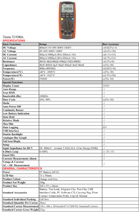

Datasheet
Datasheet from Newark website: 72-9380A.xls (farnell.com)

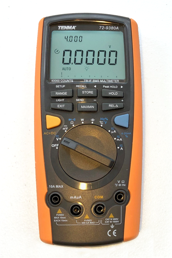

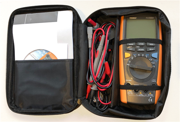

The multimeter came nicely boxed and undamaged.  The meter itself has a nice zip up case also containing probes, alligator clips, K-type temperature probe, optically isolated USB connector, manual and CD.
Right off it appeared that the supplied software probably wouldn't meet my needs because it was on a CD which was dated 2004 and I no longer have a computer with a CD reader.  The meter is quite large and feels sturdy.  When turned on it responds with a nice loud beep.  The display is large but the numbers while readable are the smallest of any of the multimeters I currently use.  There is backlighting which works well enough.  There is an analog bar graph that updates around 10 Hz.  It can store min and max values when in manual range.
The rotary switch clicks through the settings nicely and snaps to the desired function with authority.  The buttons are a bit squishy but OK.
I'm not going to comment on the high voltage aspects of the probes and meter because that is not something I deal with and I don't feel qualified.  The leads on the probe are stiff and the points not particularly sharp but I have better probes when needed.  Response of the continuity tester is quite slow with the supplied leads.

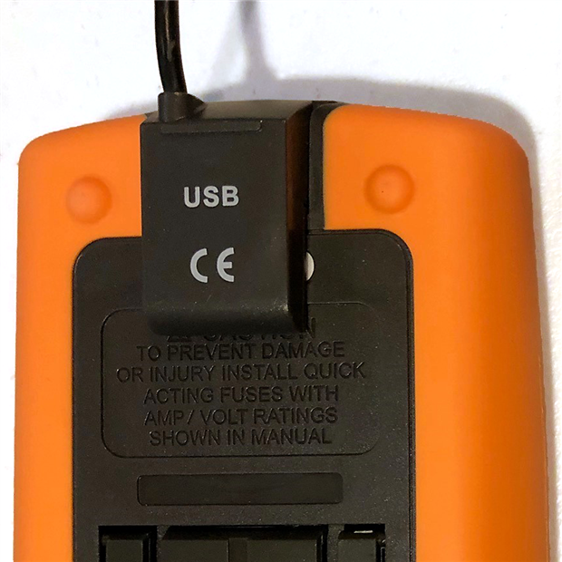

USB is through an optically isolated connection that slides into the upper back of the meter.

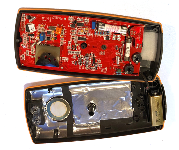

The back cover comes off when 4 more screws plus the battery screw are removed.  All 4 of these screws are self tappers.  Two are hidden by little rubber feet.  This is as far as I will disassemble the instrument.image
The fuses are huge and accessible.  The PCB is tidy and no flaws were spotted in the soldering.  However, note the sheathing that covers the power from the 9V battery is nicked open.  That wasn't done by me and must have happened when the case was originally assembled.  There are lots of interesting bits but I didn't spend much time inside and reassembled it without issue.  Again I won't comment on high voltage due to lack of knowledge and it is not my use case.

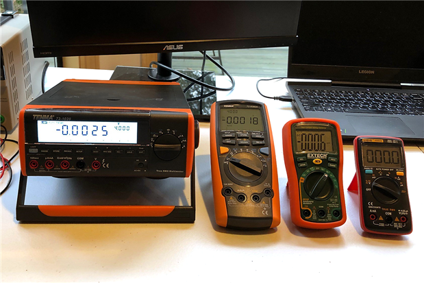

The four meters being compared are starting from the left a Tenma 72-1020 bench multimeter, the Tenma 72-9380-A which is the instrument under review, an Extech EX330, and an Aneng AN8008.
The Tenma 72-1020Tenma 72-1020 bench multimeter is my favorite and remains so.  It never leaves my bench, is plugged into AC power, has a bright display with good resolution and so far has never let me down.  It is a 40,000 count meter and sells for $261 on Newark.  I also got this after winning a Project14 contest and my recollection is that the price was closer to $200 at the time I got it.
The Extech EX330Extech EX330 was my first "good" meter and I have had it a number of years.  They can be purchased for a bit over $50 and this model was the winner in an under $100 shootout on the EEVBlog a few years back.  They were more expensive at the time I purchased it.  From time to time the rotary switch doesn't click into the Vdc setting securely now and the resolution is only fair at 4000 count.
I have two of the Aneng AN8008 meters and one of them doesn't work in the capacitor setting and the switch may be wonky.  Now that I have a replacement I may open it up and see if I can spot the issues.  The construction is not up to the others reviewed here and I certainly wouldn't trust it on mains.  However, they can be bought for $27 on Amazon in the US and shipped with 2 day delivery.  I paid less for mine several years back but they shipped from China.  They are 10,000 count meters and actually work pretty good (when they work :-).  For the price they aren't bad for a hobbyist on a budget.
In all the following tests the results in the table are in the same order as the meters are shown in the image above.  All meters are in auto mode.  The voltage source is my Tenma 72-2685Tenma 72-2685, the resistors and capacitors are just components I have at hand.  This is crude testing at it's finest.
