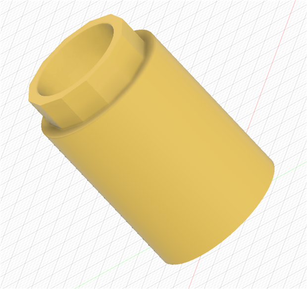

Marble Run has various plastic parts that can be put together in a kind of marble maze.  When building a structure it seems like there are never enough columns as pointed out by the youngest child.  So we 3D printed some more columns.  If you aren't familiar with Super Marble Run, here is a short 20-second video that shows an abbreviated marble setup.
The kids are gone now so there is only Bender for companionship as seen in the video.  The 3D modeling was done in Fusion360 and is fully parametric so that tolerances can be tweaked and different length columns printed.  They say you can't put a decagon peg into a round hole but that is exactly what the makers of Super Marble Run did.
Somewhat to my surprise, the first print came out and worked just fine.  The shape of the decagon seems to allow a snug fit without the tolerance problems that can arise when trying to print a rounded shape for a hole.  I'll have to remember that.  Another thought was that we could further enhance the game by adding LEDs that blink when a marble passes, a timer, ways to release multiple marbles, etc.
