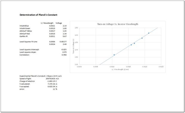

Determination of Planck's Constant
Now it is time to see how well I did.  In the table at top left and in the plot on the right the turn on voltage is plotted as a function of the inverse wavelength of the LED.  The LEDs without datasheets are omitted.  A least squares fit was then made and the slope calculated.  The data is very highly correlated with an offset from the origin.  This offset is expected due to the way the experiment was conducted but the slope should be OK.  We can now calculate Planck's Constant from the following formula:
Planck's Constant = (Experimental Slope) x 10-9 x electron charge * speed of light,  or
h = m * 1E-9 * e / c
The constant 1E-9 is needed since wavelength here is in nanometers and speed of light is in meters.  The values for other constants are shown in the table.
And the calculated value is 7.37 E-34 Js Vs. an accepted value of 6.63E-34 Js.  The error is 11%.
I think this is reasonable given the equipment and methods used.   I hypothesize that the error could be reduced by:
  • Better definition in the procedure on what constitutes the turn on voltage.  Just where does it occur exactly?
  • More accurate measurement of current for determining the turn on voltage.  Maybe use my oscilloscope and a low value resistor.  Or ask for a new multimeter for Christmas.
  • Measurement of wavelength at turn on rather than using the datasheet which is measured at 20 mA.  Don't have the equipment for that.
  • More accurate voltage measurement (this is probably second order)
  • Steadier voltage source (second order again)
