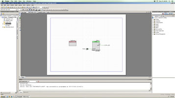

There are two parts to the TopView:
  • a PWM signal directly connected to the onboard LED on P2_1

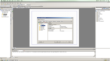

  • a CapSense component
The CapSense component can be used for different types of capacitive touch buttons. In this particular case, I opted for the linear slider.
The goal is to control the duty cycle of the PWM signal depending on where the linear slider was touched.

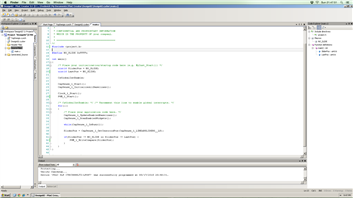

The code example was found here: PSoC 4 Pioneer Kit Community Project#02 - CapSense Slider
#include <project.h>
#define NO_SLIDE 0xFFFFu
int main()
    /* Place your initialization/startup code here (e.g. MyInst_Start()) */
    uint16 SliderPos = NO_SLIDE;
    uint16 LastPos = NO_SLIDE;
    CyGlobalIntEnable;
    CapSense_1_Start();
    CapSense_1_InitializeAllBaselines();
    Clock_1_Start();
    PWM_1_Start();
    for(;;)
        /* Place your application code here. */
        CapSense_1_UpdateEnabledBaselines();
        CapSense_1_ScanEnabledWidgets();
        while(CapSense_1_IsBusy());
        SliderPos = CapSense_1_GetCentroidPos(CapSense_1_LINEARSLIDER0__LS);
        if(SliderPos != NO_SLIDE && SliderPos != LastPos) {
            PWM_1_WriteCompare(SliderPos);
Linear Slider

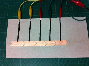

To create the linear slider, I used a piece of cardboard on which I created some shapes using copper tape. The shapes were then connected to alligator clips using conductive paint. Why paint and not just more copper tape ? Purely because I wanted to experiment with different conductive materials image
Finally, the alligator clips were connected to the kit's pins assigned to the CapSense Linear Slider. The copper tape was covered with regular tape, making it easy to slide back and forth without ripping the copper tape.

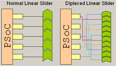

It is possible to create a longer slider with up to ten electrodes using the same five pins, by configuring and wiring the slider in "diplexed" mode. This allows for a finer granularity of the measured values.

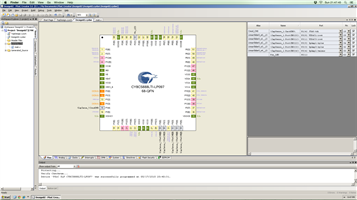

    fvan over 11 years ago in reply to Jan Cumps
    Random pins. Not aware of rules regarding Capsense and pin assignments.
    I figured as long as the pins are not in use for something else, it should work.
    Jan Cumps over 11 years ago
    fvan, how did you decide in PSoC Creator to use these pins :
    Was that a random decision, or is there a rule that defines the pins that you can use for an external capsense?
