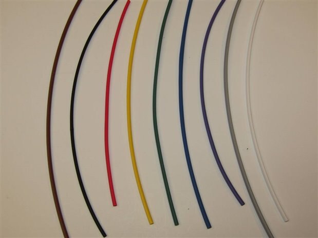

Not too long after posting this blog entry jw0752 (Thanks John!) had suggested using multi-color heatshrink tubing to mark the wire numbers.  I immediately searched on Ebay and found the 10 colors (resistor color codes) available in 1/16".  I had been a little busy, but ran into some time today and decided to try it out.  Here are the results:
Using the standard resistor code colors, I used two pieces of heatstrink per wire.  The first piece, represents the 10's place, I used black (0) or brown (1), using 0.3" of 1/16" heatshrink tubing.  For the second piece, representing the 1's place, I used the remaining colors, using 0.1" of 1.16" heatshrink tubing which I centered over the first piece.  For D0 (black/black) and D11 (brown/brown) I left off the second marker.  (Note: the heatshrink supplier sort of cheated on the green and blue tubes as these were actually small diameter, fortunately I had also ordered some other sizes of these multi-color heatshrink (1/8" and 3/16" diameters) so I was able to substitute the 1/8" diameter for the second piece).  The results are far more readable and I am quite happy with the readability of the leads.

    jw0752 over 7 years ago in reply to genebren +6
    Hi Gene, Along with labels, heat shrink ranks right up there as one of my obsessions. I buy it whenever I see a deal or a good looking assortment. For the fun of it I just checked to see if I could cover…
    genebren over 7 years ago in reply to jw0752 +5
    John, I will have to try looking for other heatshrink vendors/distributors. You would think that resistor-like color coding would be a pretty normal usage of heatstrink. Thanks for the kind words, Gen…
    jw0752 over 7 years ago +4
    Hi Gene, I like your process for working towards a solution to this need. I too have looked for the proper colored heat shrink so that it could be used for color coding numbers using the standard resistor…

    roosoft-farnell over 7 years ago in reply to genebren
    What I have done before with multi coloured heat shrink was to cut segments out from two colours and space them every few cm along the wire and then overlay them with each other to fill in the gaps. Becuase the heatshrink all came in the same lengths I was able to do mutiple sets. It was particularly effective because some of the heatshrink was flourescent and so really poppped!
    genebren over 7 years ago in reply to jc2048
    Jon,
    That is a clear and concise marking strategy.  I have some multi-color heatshrink tubing coming (in the mail) that I hope to use in a similar manner.  Due to having 16 probes I will need to use two colors (again, I might try the bidirectional approach, 10s, 1s, 1s, 10s markings).

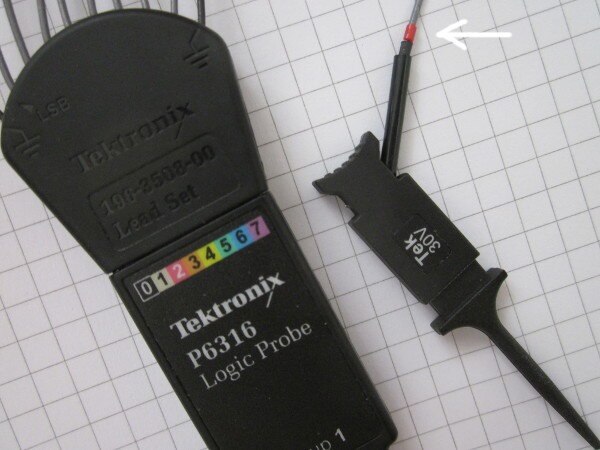

    jc2048 over 7 years ago
    In case it's of any interest, this is how the logic probe leads on my Tektronix MSO 'scope are labelled - just a little patch of colour. They come out in groups of 8, so there's only need for one colour. It looks like wrap but it doesn't go quite all the way round.
