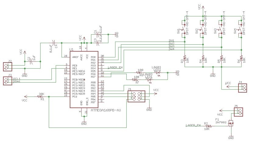

Seeing how there were no available pins to control the lasers, I decided to update the design an create a more flexible and extensible controller.  My plan was to keep all the existing functionality, but to add the laser mode and fix a few issues that I had with the functionality.  For the Laser mode, my plan was to use the 'Enter' button (while in the normal intensity mode), to turn on the lasers and reduce the Light ring intensity by 50%.  The lasers would stay on for 30 seconds, or until the 'Enter' button pressed again.  Another change was to modify the auto sleep function.  In the prior design, when the sleep timer expired the Light ring would immediately turn off.  Several times over the years of using this device, I would be in the middle of a delicate soldering operation and the light would go out (usually followed with me making some sort of exclamation).  My plan here is to create a warning period where the light ring would begin to blink (very short off time) to indicate that sleep was approaching (for 30 seconds), allowing me to press a key to keep postpone the sleep cycle.
Looking through my inventory of parts, I decided on using my trusty friend, the ATmega328PB processor to replace the ATtiny45 processor.  It took a bit of cramming and creative layout to fit a 32 pin TQFP processor in place of the old 8-pin SOIC part, but I was able to fit it, along with an actual ISP connector.  Here is the revised schematic and layout:
The new design includes a ISP connector (J1) a split, through hole connector (J2 and J3) for the USB cable to the light ring, power connector (J4 - also a USB cable) and the new laser connector (J5).  The switches are now directly read by normal GPIO inputs.  The layout uses the same outline and switch/LED placements.  The ISP connector is left unpopulated, but I can easily connect the programming pod when needed to make firmware changes, but still allowing the new board to fit into the existing controller enclosure.
In the process of designing this board, I did make a few errors (these things continue to happen as the old brain is not a sharp as it once was).  One mistake was to use the wrong I2C port (wrong in that my compiler has a built-in library for SDA0/SCL0 and I used SDA1/SCL1, so I needed to use a bit-banged method of generating the I2C port).  Another mistake was the footprint that I created for J3 used holes that were too small for one of the leads in my USB cable and I ended up only using a few strands on one of the leads (a little too fragile for my liking).
Errors aside, it is up and working.  I am currently printing a new laser holder that includes a mounting plate for the controller enclosure.  Here are a couple of videos demonstrating the new features:
