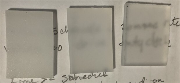

I discussed my initial design thoughts and detailed design for my smart lighting project. Today I am updating my progress with some experiments concerning the light diffusers.  Early on in this project, I had decided that the raw LEDs where creating toe bright 'hot spots' on the art glass panels, leaving an aesthetically unpleasing effect. Not really having too much experience with diffusers, I started with a shotgun approach of ordering a wide variety of acrylic samples from an online company (TAP Plastics - an pretty awesome company that I was very familiar with from living in California, but unfortunately not present in Texas). I ended up selecting six different items, with different texture and rates of transmission, varying from clear to white (no desire to tint at this point).  On initial tests, I found that texturing offered little in way of diffusion, so I whittled the selection down to three choices.  Here is a look at the choices:
From left to right the samples are:
  1. Satinice White Acrylic - White - This material has a light matte surface (both sides) with light diffusing beads embedded in the acrylic, providing up to 59% transmission.
  2. Lighting White Acrylic - This material has a smooth surface, with coloring to provide a white glow, providing up to 69% transmission.
  3. Satinice White Acrylic - Clear - This material has a light matte surface (both sides) with light diffusing beads embedded in the acrylic, providing up to 89% transmission.

On the left is the result of a pair of the Satinice White panels attached.  I really like this image, as it shows coloration and texture of the art glass panels, while obscuring the LED hotspots and the inter-workings of the light fixture (PCB and battery).  One right is the result of a single Satinice Clear panel (bottom) and bare LED (top).  I am still not happy with the bare LED part as it has too much of a hotspot, while the Satinice Clear seemed to do a pretty good job on the diffusion.  The degree to which the PCB and battery show in the image is somewhat distracting to the overall effect.  I might try to use a pair of the Satinice Clear panels tonight to see if it obscures the PCB/battery.  I also plan to place the light fixture into its clear acylic tube to see if it has any effect of the lighting.
