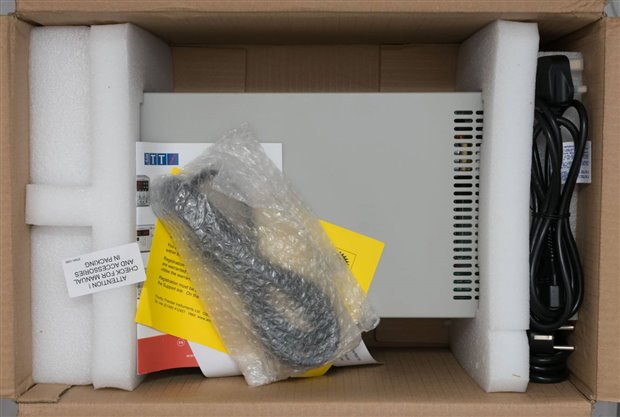

Opening the box, the power supply is packed inside foam ends which keep it securely suspended from all sides to avoid damage and absorb shock. The paper documentation and US mains lead are left to “float” about in the box, which is not ideal, as the power supply is not otherwise protected and harsh shipping could cause some damage to arise. The original UK/European mains leads are tucked into the side and top section of the right foam end-piece – this is a more secure arrangement and cleverly avoids the LCD screen area, but perhaps it would be more ideal if it were in the other foam end-piece instead as that one is holding the rear of the unit.
The paperwork includes a certificate of conformity, an extended three-year warranty notice to register on their website and a small safety documentation booklet. Other documentation and software materials can be downloaded from their website – this to be expected nowadays as it reduces costs, ensures materials are up-to-date and is more environmentally friendly.
The three included mains leads are as expected – note how thick the US lead is compared to the UK and European ones. This is because their lower 120V “nominal” mains voltage requires nearly twice as much current as 230V, so it’s good to see that the appropriate cable is included.

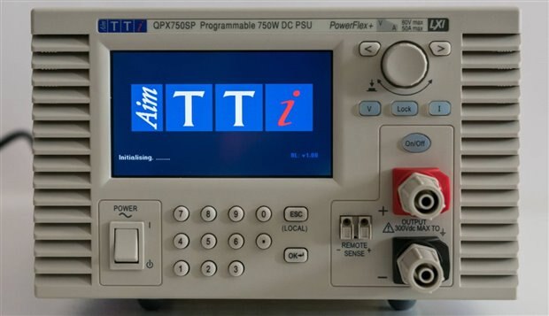

The instrument front panel is decidedly beige-toned with vent grilles flanking both sides. The resistive touch LCD screen occupies most of the area of the front panel. This is flanked on the right with a clicky rotary encoder to change values, arrow buttons to change selections, and light-up buttons for selecting voltage, current and front-panel lock functions. Below the display is a numeric input keypad which has the zero and decimal displaced (which may take some getting used to) and the Escape and OK buttons.
The power switch is in the bottom left, as seems to be convention with many instruments. The casing makes it stand out with a bit of a “moat” engraved around the area. A similar emphasis is given to the front panel outputs which include two of their shrouded binding post terminals, two tool-less terminal block connections for remote sense and a light-up channel on/off button.

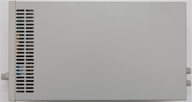

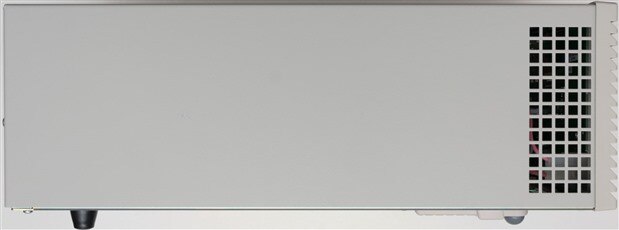

Other views of the unit show that it has been designed with an intentional front-to-back airflow design with relatively large vent holes that ensure low air resistance. These holes continue all the way around the unit, including the bottom. The square vent holes measure 5.7mm across, which makes them the largest that I’ve seen – the risk could be inadvertent entry of items or vermin into the unit. The unit has rubber feet on the bottom with flip-out plastic props which allow the unit to stand up at an angle for better ergonomics.
With regards to the plastic props – they are either up or down without any adjustment. I found the height a little higher than I was expecting.

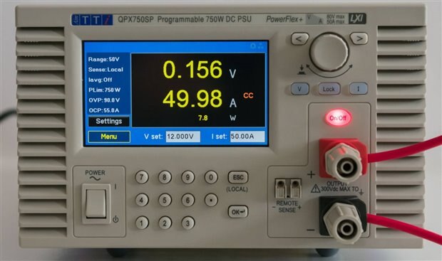

A quick functional test shows the unit is alive and well despite its long journey around the world. This means it’s ready to run the gauntlet of tests that I have prepared for it.
